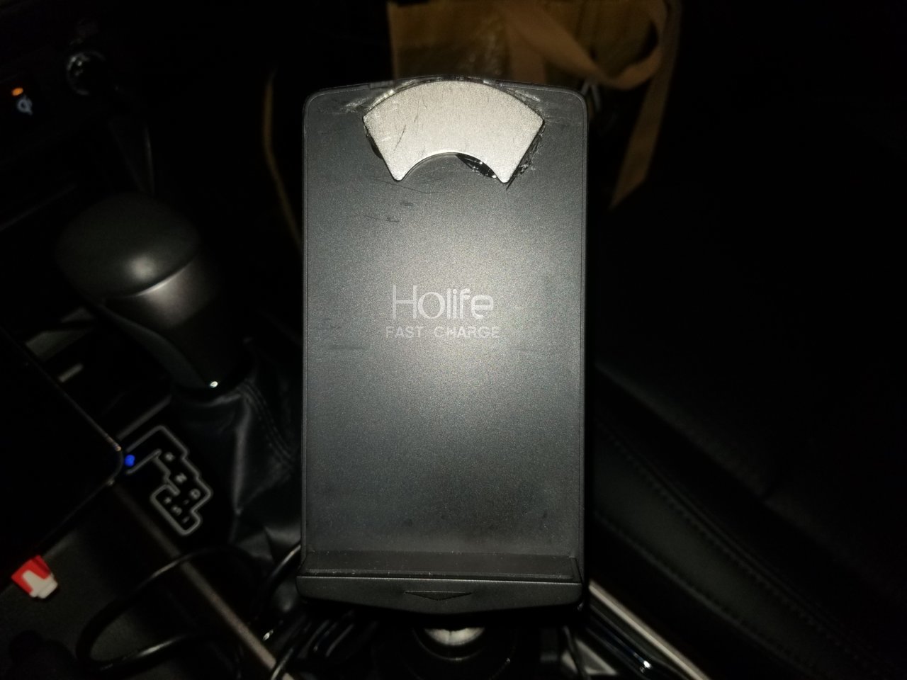

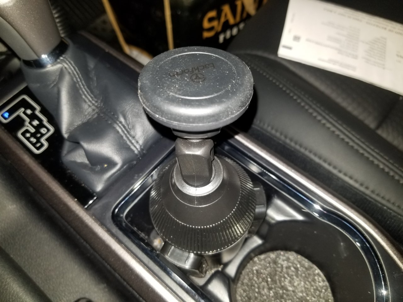

    Ok, so I have one of the phones that causes the builtin Qi charger to overheat. I may have found a solution.
    I bought a magnetic cupholder phone mount and put it into the useless rectangular bin fore of the round cupholder. Then I got a fast charge wireless charger and attached one of the metal plates to the bottom of it. I then set the wireless charger onto the magnetic mount. How do I stop it from flying around when I take a curve you ask? I took a deodynium magnet from a spent hard drive and hot glued it to the wireless mount and put a metal plate inside of my phone case. I had to make sure the plate didn't interfere with charging and held the phone in place. Success on both counts.
