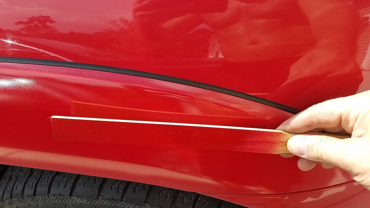

    Researching the Chrysler PRB, R87 color code; it is called Radiant Fire for Duplicolor Perfect . The picture shows the comparison between Radiant Red and Radiant Fire. The radiant fire is just a bit brighter. To be honest, my truck is more of a radiant fire, from the sun fading, than the 3L5.
    I would like to try different shades of primer (light grey or dark grey) to see if I can get radiant red to be not as bright and blend to a 3L5 a bit closer.

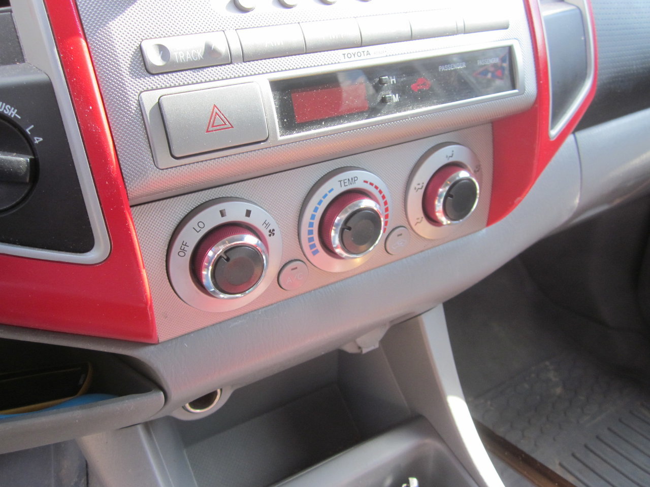

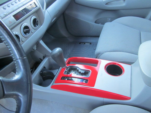

    I use Antomotivetouchup.com as well. Perfect match! All these mods were done with their spray cans.
    Eyelids.
    Dash

    Update guys! I tested a few paints and the perfect match is Dupli-color super red 2! Only $5 bucks a can!
