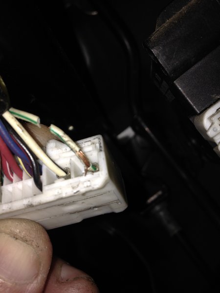

    Okay. So here wire #1 cut. White with green tracer. Still have dtrl. What I'm I doing wrong here???

    That is the exact wire that I cut and mine went off.

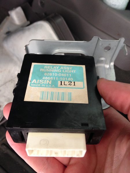

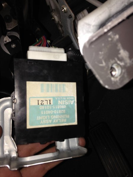

    Well the TSB on it says pin 2. that would be white and black. Have you tried pulling the drl relay?
  12. Mar 10, 2017 at 2:37 PM
    #32
    coryohana
    coryohana [OP] Well-Known Member
    Dec 11, 2014
    #144076
    214
    Cory
    Ventura, CA
    2002 Prerunner TRD 3.4 Auto w/locker
    *Magnuson Supercharger *OME suspension with 880 coils *Dakar Leaf Pack *SCS F5 Dark Bronze, wrapped in KO2's *Custom Diamond Back bed cover and rack with custom storage *LED exterior/interior light replacement *SS brake lines *TC LCA Cam Tab gussets *TC UCA
    What's the drl relay? If you mean the black box that the wiring goes harness was plugged into?
    I tried starting the car without that plugged into the wiring harness. And headlights had no power.

    Do not cut that wire . it is a ground . read all the links I sent you and see what other people have said . When I did it I just cut that exact wire you did and the daytime running lights went off .
