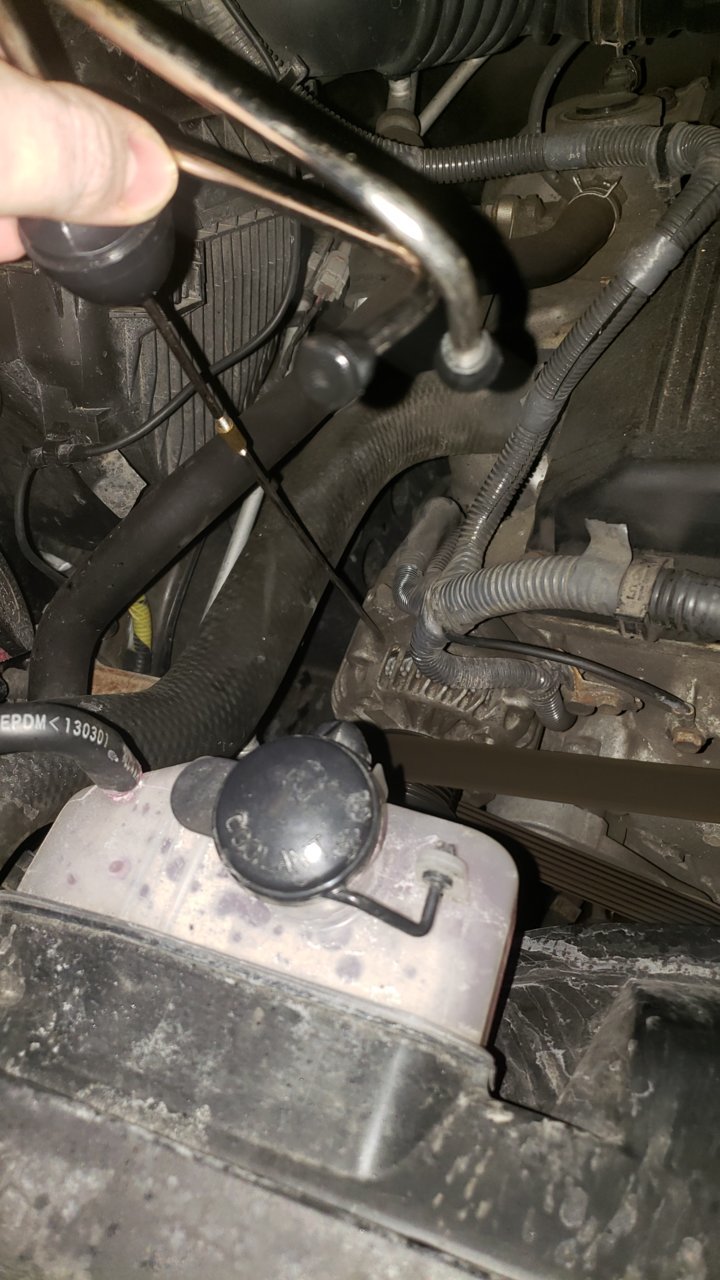

    Placed stethoscope at the location shown in the above post. Sounded much louder than similar areas around other pulleys. However earlier when i disconnected the green connector on the alt noise was still there....maybe just the pulley is bad?

    The bearings that support the shaft inside the alt. are what's gone bad. You can take the alt. apart get the bearing #s hopefully and look them up online and order new ones. Or just go with the Denso option.
