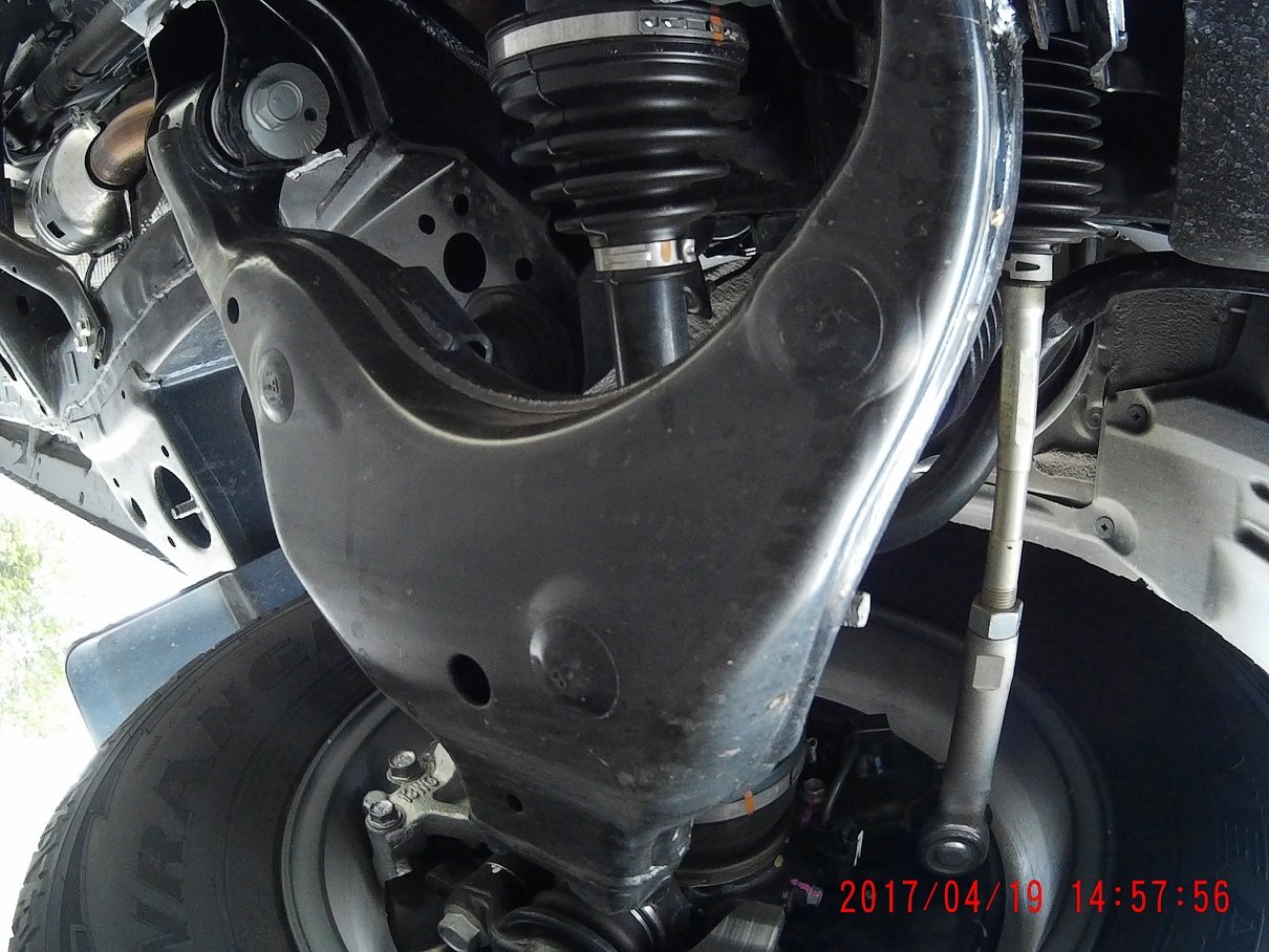

    I have plugged all of the LCA’s holes and I’m still getting a howl on my right fender side and I’m determined it’s from one of these holes.. anyone else having issues after the LCA’s are plugged? 2A3E02E4-9D5F-4108-A1E9-45932F561C48.jpg427CCD2D-0A8E-4F9B-947C-E73C87EE722E.jpg
