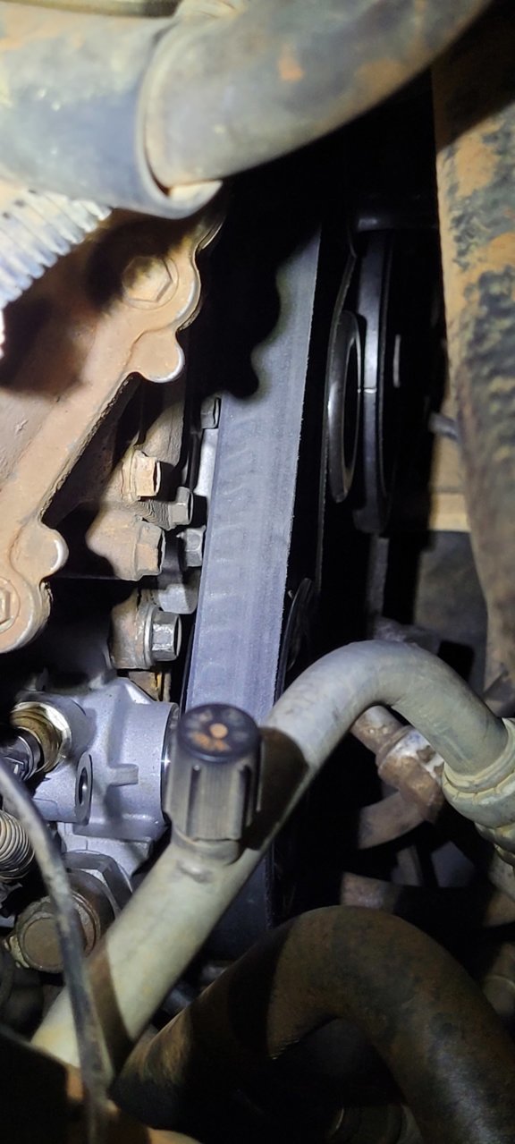

    Found some interesting belt wear.. I wonder if the harmonic balancer could be going out? I would imagine I would have much more vibration issues if that were the case. No wobble from anything though.

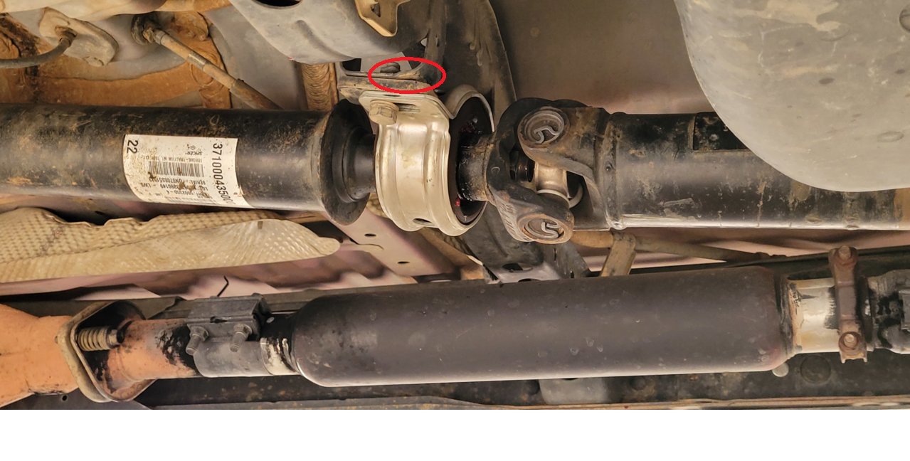

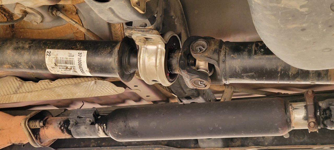

    Here's a picture I just took, very hard to tell it failed from looking at it. It is slightly off center and I thought it was because of how I flipped it initially when installed.
    I just checked when I purchased it, this cb was purchased in October 2020 so it failed within a short amount of time.
    Disregard the crappy exhaust clamps.. I need to weld my exhaust together already lol

    Is this the "Swiss Cheese Effect" where all the manufacturing tolerance "holes" just lined up against you and the problem fell all the way through?
    Never hear of anyone else with issues like this where the carrier bearing drop spacers didn't solve alignment or angle issues, let alone having to move the carrier bearing back significantly.
    Have you seen the "construction adhesive packing" carrier bearing mod? Did this with mine and it's been going great.
