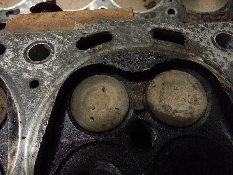

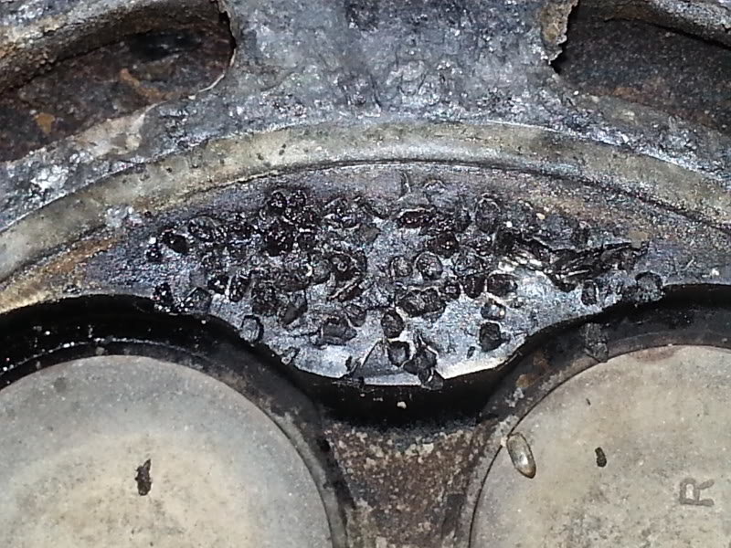

    It starts correctly now, thanks to the best dealer tech ever.
    [FONT=&quot]Hi fellow Taco fans, newbie here, would appreciate input on my Taco. Last Sunday our 1998 4wd TRD Off Road automatic 3.4L V6 Taco w/195,000 miles (5vzfe) began mildly lurching at interstate speeds, then making a knocking/tapping noise. No check engine light was thrown. Towed to Toyota - service tech dx’d spun rod bearing [/FONT][​IMG][FONT=&quot] based solely on the noise (didn't open 'er up at all - we declined further dx due to $$$). They also said possible blown head gasket, but we don’t see obvious signs of this.[/FONT]
    [FONT=&quot]Towed her home, pulled the NKG spark plugs, and found one of the coil pack plugs (#3’s) nickel center electrode was completely missing from its porcelain surroundings (not corroded or broken, but rather just completely gone)[/FONT]:confused:[FONT=&quot], and the inside of the boot it rests in was coated with carbon build up. Both ground (side) electrodes of that same plug appeared normal and intact. All other plugs looked fine. Could that missing electrode be bouncing around inside engine components and causing the noise/damaging stuff along the way, instead of a spun rod bearing? What could cause that electrode to go MIA? [/FONT]
    [FONT=&quot]Other things we've tried at home in an effort to pinpoint the problem were:[/FONT]
    [FONT=&quot]1) Drained the oil - pretty sure we're seeing tiny metal specks in it. Not chunks or pieces, but shiny specks. [/FONT][​IMG][FONT=&quot] Pic attached.[/FONT]
    [FONT=&quot]2) Put a borescope down the bad plug's boot and beyond, and think we’re seeing a hole in the top of the piston - not certain. [/FONT][​IMG][FONT=&quot] Pretty sure we saw shiny specks like what we saw in the oil. Can try to post borescope video if helpful.[/FONT]
    [FONT=&quot]3) Started twice for just a few seconds each time since initial incident, to see if any changes/clues. Noise is definitely changing. [/FONT][​IMG][FONT=&quot] Initially, the noise was a knocking/tapping in an inconsistent pattern/rhythm. Mid-week, it was more of a consistent tapping. Last night, no tapping/knocking initially (we assume due to oil change), but a mild squeak/squeal was present for the 1st ~5 seconds, then that went away and the knock/tap noise came back within 10-15 seconds of starting it. A neighbor revved the engine at the accelerator line under the hood, which caused the noise speed to increase to a fast inconsistent rattle. Will try to attach videos.[/FONT]
    [FONT=&quot]We've certainly used and abused her since we got her in 2004 (occasionally hauling/towing heavy loads; countless miles of windy, mountainous, pot holed, rocky, washboard, dirt/gravel road driving while weighed down w/tons of coolers/gear/dogs/etc [/FONT][​IMG])[FONT=&quot], but at worst we’ve only flirted w/weight capacity limits, and we’ve taken EXCELLENT care of her – although who knows what her care was like during her 1st 70,000 before us. On one hand, she's 17 yrs old w/nearly 200,000, and in virtually any other type of vehicle, I’d expect major prob’s like this and would lean heavily towards replace. On the other hand, WTF, she's a TACO!?!?!?!?? Theories as to why a Taco w/195,000 would have severe engine prob's? We are totally shocked. [/FONT][​IMG][FONT=&quot] Also, what kind of life span might we expect on the tranny? Average costs for tranny rebuild (if our luck was actually that terrible after doing an engine repair)? [/FONT]
    [FONT=&quot]If the missing center electrode is the culprit, thoughts as to what engine components might be damaged and what kind of repairs we'd be looking at? If it is a spun rod bearing, only options are to have our engine rebuilt, or have a reman or used one dropped in - sound right? Which is better? Oregon folks, can you recc' good Taco mechanic for engine prob? Looking at Toy Doctor (Tualatin), (EDITED SEE BELOW), and a few others…good/bad feedback on either? My husband would love to do it himself and save serious $$$ (it's rare that he lets anyone else work on her) but fears he'd be in over his head [/FONT][​IMG][FONT=&quot] w/an engine prob, plus w/no garage, constant rainfall, and limited time/tools for something this major, we're leaning towards someone else doing it. Any advice on how big of an undertaking engine overhaul on this old girl would actually be if he decides to go for it? Any amateurs attempted it and been glad/regretful after? How tough is it to pull the engine, have it rebuilt at a machine shop, and put it back in, vs. rebuilding it start to finish? Any other diagnostics we could try at home to help us determine whether it's really a spun rod bearing or other problem????? What to look for in terms of possible blown head gasket? [/FONT]
    [FONT=&quot]Many thanks for reading. Any and all thoughts and opinions would be much appreciated.[/FONT][​IMG]
    P.S. Anybody ever sue a spark plug company?[​IMG]
    EDIT: Anyone who's reading this thread because they have a similar problem, I will post a start to finish summary of everything at the very end - not quite there yet, but hopefully soon! Guessing no one will want to read this many pages of stuff!
    EDIT: I've deleted the name of the business that replaced our engine from this post, because problems developed with the truck after the work they performed, and those problems are still in the process of being diagnosed as of today 2/4/15. Until I have a full clear picture of what these issue are and what caused them, I do not want to recommend or speak poorly of their business. Thanks.
    EDIT on 5/15/15 (conclusion - solved!): Post #2853 is where a brilliant dealer tech borescoped our intake manifold and saw our fuel injectors leaking, even though they were passing on injector testing machines. We basically replaced every part under the sun in an effort to fix this problem prior to finding this guy. Yeah, we're pretty damn happy we finally DID find him - our Taco starts like it should again! :)

    First thing you need to do is pull the head on whichever side the spark plug broke on. Determine the damage and go from there. Everything else is irrelevant until you pull that head. It could be bent valves, hole in piston, bend connecting rod, hole in head....who knows?

    How much damage was done to the cylinder, piston, head and valves if any. These are all crucial.
    A engine swap with similar 3.4 v6 and same fuel injection would be simple. Unbolt/unplug......bolton/plug in. I think with you helping your husband it and the necessary tools could be done in a weekend.

    spark electrode is small enought it should just be shot out through an exhaust valve, doubt that is your noise

    if he was lucky, yes, but it is also small enough to get stuck between the piston and cylinder wall doing serious damage digging into both including possibly cracking the rings that in turn might have sharp metal gouging edges doing more damage. and the resulting damage to things can be the source of his noise

    Probably a bad spark plug installing socket caused this whole problem. There is a reason there is a insulator cushion down inside that socket and that a person need to take his time when installing spark plugs. If you lay that socket wall against the insulator,,and leverage it out of straight-line plane as you tighten,,Snap goes the delicate porcelain!! or center electrode. And now you have a missfire(or worse) that is extremely hard to find. Ask me how I know.

    Hi all. Thank you thank you thank you everyone for your input, I can't tell ya how helpful it's been!! Thanks in large part to the helpful, encouraging info I've received on this thread, we're now considering swapping the engine ourselves, which would save lots of $$$$! Been reading a ton, watching Youtube videos, and discussing the heck out of it w/anyone that will listen, so while we still have lots to learn, swapping an engine is sounding less and less scary.
    A mechanically inclined friend recc' considering a JDM motor - he said it'd be a low miles engine from a car in Japan, and could be a better price than buying a reman. Although then we'd still have the question mark of how that engine was treated before we acquired it, which is why I ruled out a used engine right off the bat. But that was when we looked at engines w/100-150,000+ miles....a brief search of JDM's this morning revealed engines w/less than 50,000. Hmmm. Thoughts?
    Husband is reading Haynes manual engine chapter right now. Initially he was 99% opposed to doing ANY of the work ourselves, due to a gravel driveway in the rainiest climate in the US being his "garage". :crapstorm:Aside from it being a miserable work environment, he's mostly been concerned about what if things under the hood get water/dirt on them. BUT, we do have a decent sized shed/workshop - so we've now visualized buying engine hoist and engine stand and setting up the stand in the shed (where there are lights/heaters, and shelter from rain/dirt) - then we'd just have to figure out how carry a 500lb engine ~75' from driveway to shed. Wonder if we could get some heavy duty tires onto a hoist or stand somehow? I feel like I'm painting a really amusing picture right now......:laughing:
    But if we could figure that out, then the idea would be, he could start taking stuff apart, and strip down to short block, inside the shed. My impression is that things we could gain from this would be:
    1) Perhaps finding the cause of the problem - that'd be BEYOND satisfying after going insane from guessing![​IMG]
    2) Perhaps realizing that we only need a short block, rather than a long block, or dressed long block, and saving some $$$. Right?
    Things we could lose would be:
    1) Time. Which is totally worth losing for something we care this much about, and that costs this much $$$$ for the fast mechanic route!
    2) Cost of engine hoist & stand, and perhaps something for equipment to move it from taco to shed. And maybe more plywood to reinforce shed floor - you guys think the current single layer 1/2" thick ply floor would be enough to support the 500lb engine on a stand, plus 2-3 average sized people? Not positive on ply thickness - will check now, but could be 3/4" (hoping not 1/4"!! Previous owner who built it seemed smarter than that though)
    We watched a YouTube where a guy w/our same engine (in a 4 runner) stripped everything down to the short block (or at least that's what it looked like, but video was posted in fast forward), THEN once it was stripped he hoisted it out, brought a new short block back (or maybe just had his machined?), then put that on a stand and started adding stuff, til it became a long block, then a dressed long block, then hoisted it back in. Question - do you HAVE to strip it down to a short block before hoisting out old one, or is it optional but easier, or ????[​IMG]
    Thanks everyone! I honestly think if it wasn't for this forum and the support we're getting, it'd already be at a repair shop. And we'd be severely stressing over how we were going pay $$$$, and praying that shop was honest and did good work - seriously agonizing whether we did the right thing, especially since 99% of the crap life throws at us, we DIY our way through - so why should something this special to us be any different!?!?! I would MUCH RATHER be where we're at right now than be in that situation. Might be the :turtleride: route, but that's OK, the other car is running (knock on wood!). Even if we still chicken out and go the mechanic route, at least we'll have no regrets, cuz we'll know we thoroughly explored all less expensive options, done by people who actually care about the outcome (us!), and not someone we may not be able to trust.
    Point being - you guys rock!!:bowdown: Please keep all that great advice coming, and promise you'll still be there if we start hoisting stuff out, since I'm guessing that will open up a whole new level of questions!!!

    ^spark electrode in a running engine, cracked the head. Piston showed a couple little dings, nothing serious. This was out of my $200 taco thread.
    If OP was closer, I have a bottom end with just a couple dings in piston #3 :laugh:
    It actually ran pretty well in that condition, no idea when the previous owner did the damage. I bought a 'new' engine after I pulled the head thinking it needed a new head gasket.
    I've got a new head gasket available too!
    I just did plugs in my 'new' 2000, I don't know if NGK were the original plugs but these things looked like it. Gaps could be measured in inches and both electrodes burned to about nothing. No codes, ran fine, 110k'ish miles. I picked up 1-2mpg with new autolites.
