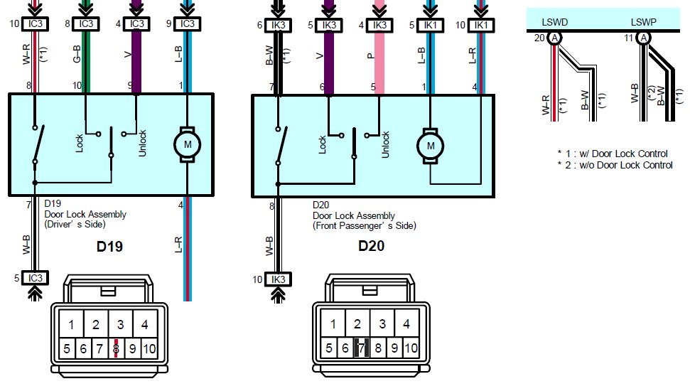

    There is a sensor inside the door look assembly that tell the locking circuit if the door is indeed closed & locked.
    toglide[OP] likes this.

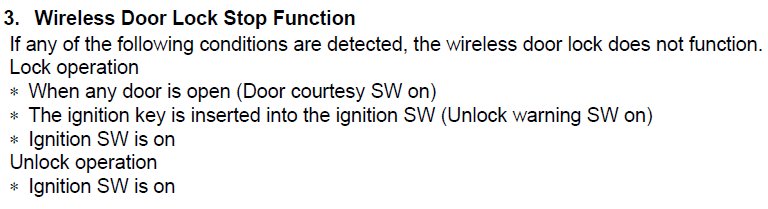

  14. May 30, 2021 at 8:24 AM

  15. May 30, 2021 at 8:43 AM

    Had some time today to dig into this. At this point, I'm suspecting a wiring issue because from all the reading I was doing there is not a whole lot of programming you can do to a Gen 2.
    This is what I believe is going on. The door lock control box is not seeing the state of the door "locked or unlocked" and is trying to keep me from locking my keys in the truck.
    Pulled the door panel off and pulled out the door lock assembly and thanks to @ caribe makaira I was able to test it.
    Both the lock and unlock switches in the door lock assembly were working normally during testing.
    Ok now I'm thinking to check the wiring in the door, I put the door lock assembly back in and hook up the connector. Before getting too much deeper into this I decided to check it again. And just like that, the problem is gone. Not sure what fixed it but it is gone. I'm suspecting the connector was dirty and hooking it up a few times cleared up the problem. Checked it like 10 more times and it is still working. I'm going to call it fixed for now and see if it come back. At least I have a better understanding of what is going on now.
    Thanks to all of you for the help
