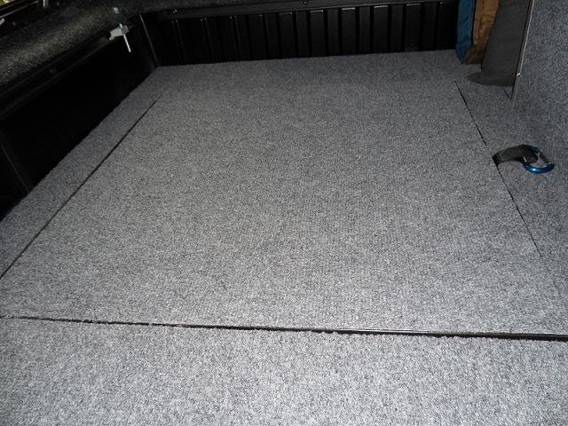

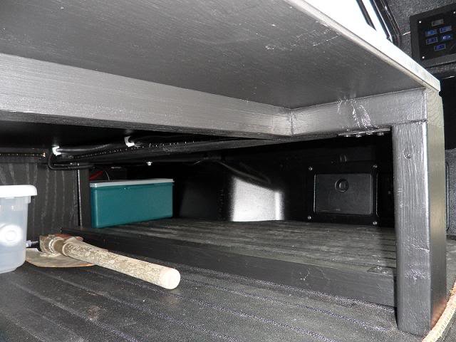

    A lot of people have been asking me for more info about the built of the platform so I went ahead and took some pictures today now I am back from a 5 day work trip to Kentucky.

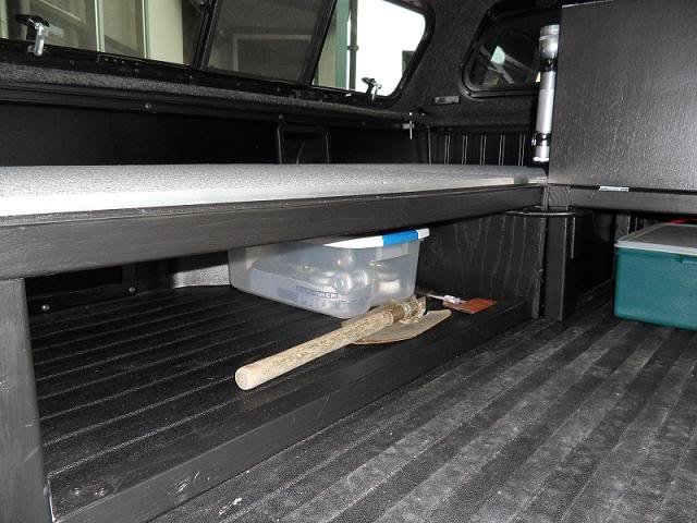

    I pretty much built a frame with 2x2 and 2x4's with a 1/2 piece of plywood on top. The frame is on one side sitting on the edge in the bed and on the wheel well, the other side is supported by a 2x4 frame:
    The smaller frame that holds the storage box is a tight fit between the big one and the other side of the bed and they are both bolted together:
    The storage box is sitting on top and also bolted down. This way when I want to go camping with two people I can just remove the box and put a piece of carpet plywood instead. I still have to built the part that will fill up the open space to sleep a second person.
    The back part of the left platform is enclosed with a lid that opens up. I used a strap with a carabiner so when I open it I can clip it to the cargo net:
    If you guys have any questions let me know.

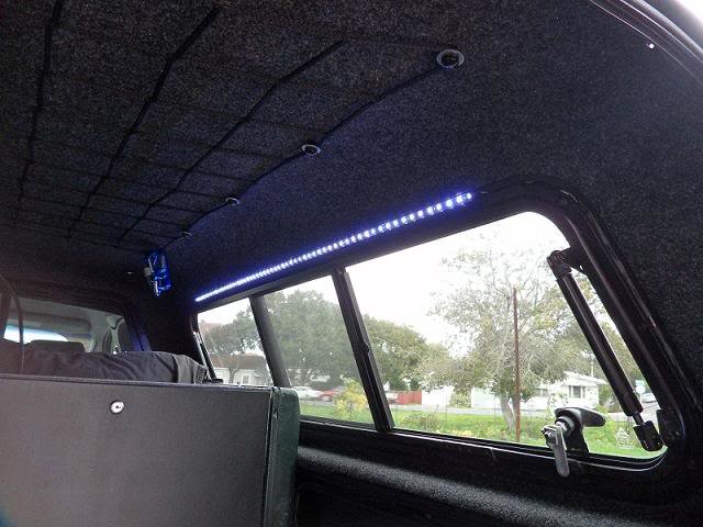

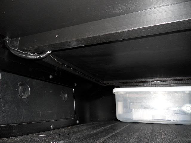

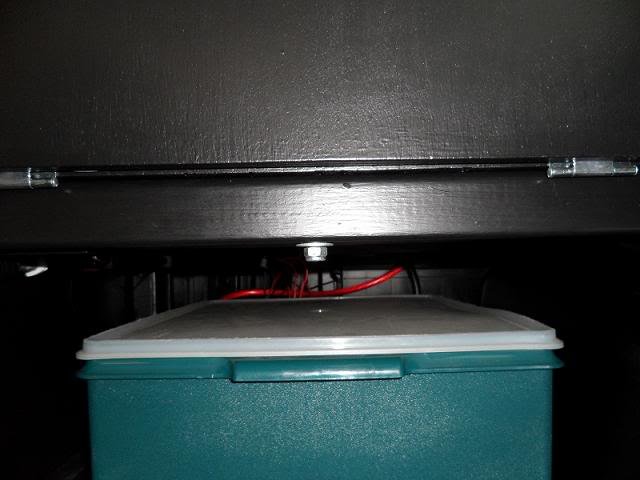

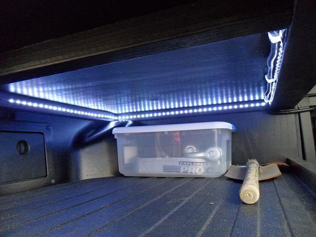

    I also installed some LED light strips that are hooked up to my switches.
    On top of the windoor frame:
    Underneath the platform so I can find things at night:
    The cheapest I found them was on ebay. 120cm for $9.19 with free shipping:
    Shipping took a while since they are shipped from Hong Kong but for that price I didn't mind waiting for about two weeks. Let's hope they last for a while :)

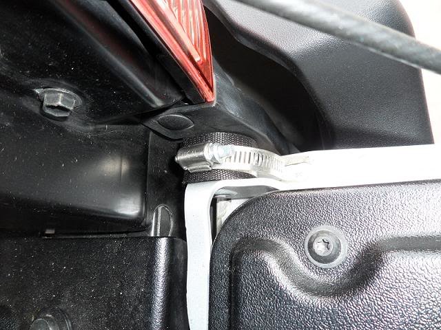

    I also installed the security fix for my tailgate today. I found it at Pep Boys and it came in a pack of 2 clamps so I did each side:
    And with the "key" removed:
    I didn't cut off the extra length of the clamp so when somebody would try to take them off with pliers they would need a long time to get it off.

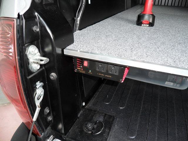

    Then I also installed an inverter I had laying around that is hooked up to my 2nd battery so I don't need to run the engine to have a working outlet in the back:
