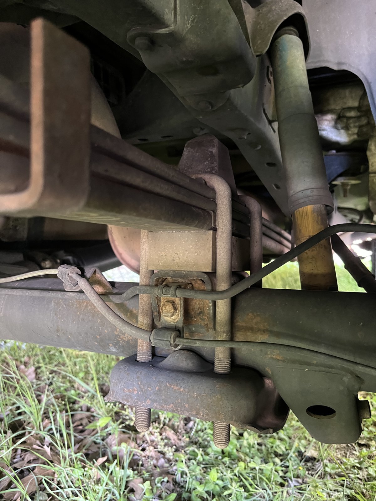

    2011 Off Road Double Cab Short Bed here. I’m having some issues with my truck that I believe are related to the suspension, some squeaking and vibrating, plus the shocks are pretty worn out and I think I’d like a small upgrade anyways. I’ve read everything I can possibly find about 2nd gen suspension and lifts on this site, but I feel like I still have a few questions.
    I’m just looking at the Bilstein 5100 set. I believe I can use the stock coils with those, correct? And still lift the truck a bit? My main question is, I understand the stations on the front shocks to lift, (0”, 0.85”, 1.75”, 2.5”), and I’m looking at either 1.75 or 2.5—but what would I need exactly on the rear of the truck (with the rear 5100s) to level out the truck (as close as I can)? I believe I have the stock leaf pack on there right now. Does anyone know or have suggestions for what I would need to add in the rear to level out the truck at each of the 3 lifted stations? Or especially the 1.75 or 2.5 (don’t think I’ll do 0.85, but not sure yet)? Add a leaf? Sizes? Or a kit that solves this question? Thank you.
    And then another question would be does anyone know anywhere I could order the 5100s that is reasonable/a good deal right now/currently? Any tips? All the links I've clicked on in the forums are dead...
    And then lastly, so I think I have a body lift on my truck right now (see pictures). It came this way when I bought it used. I’m pretty positive I’ll put on the 5100s, but in deciding the height of the lift, I really like the height it is at now— does anyone know a way I could measure exactly the amount of lift I have now? Like maybe comparing the stock height to my current height? I just don’t know those numbers and how to exactly do that. Thank you. Sorry for the length.

    I think you may be confusing a body lift with your shock spacers (two entirely different things... Body lifts consist of spacers on the cab (body) mounts that raise the cab & bed higher above the frame).
    As for determining the amount of lift you have now, measure the thickness of your spacers. The spacers up front will have approx a 2:1 lift ratio, the rear will be a 1:1 lift ratio. So if those front spacers are, for example, 1.25" thick, they should have lifted the truck 2.5" (this is assuming the shocks/springs are stock).

    For the rear, options include keeping the spacer block you have, add-a-leafs (might stiffen the ride slightly), new (lifted) leaf springs, shackle inversion, or any combination of the above.
    IMO new leaf springs would be the ideal way to go (the Icon RXT leafs consistently get good reviews and come with an extra leaf for three different lift-height/load-carrying options).

    @4x4junkie Dang, thank you so much for all that info. It is extremely helpful.
    You are totally right—I am confusing a body lift with the shock spacers, thanks for setting me right. So NO I do not have a body lift currently, sorry about that.
    Thanks for telling me those lift ratios, that really helps. Makes total sense for how to measure what I'm at currently.

    And thank you @OffroadAlliance.com extremely helpful as well. I don't a ton of money at the moment unfortunately, so I can't afford new UCAs, so sounds like it is a bad idea to go over 2". The thing that worries/concerns me is, judging by the shock spacers in the front and the block in the back, it looks like the truck is maybe over 2" already, and the former owner definitely has the stock UCAs on there. Dang and I've been driving like this for 2 years now! Ya'll think that could be what is causing some of my vibration and suspension issues?
    Thanks so much for the rake info. So yeah I'm going to remove that shock spacer up front and put on the 5100s. And sorry, just to clarify completely, let's say I put the 5100s on the front at the 1.75" station, you're saying I won't need anything on the back and it will be pretty level correct?
    Yeah...I got a lot of miles, just went over 200k, so a new leaf pack maybe in order...

    I would say if $$$ is tight, keep the rear blocks for the time being... They're already there, not too ridiculously tall, and good chance it'll match up well with whatever front lift (shocks) you put on. As time goes on you can decide later whether you want to swap them out for new leaf springs or not.

    @4x4junkie Ahhh ok, cool, I'm down to keep the block back there. If it doesn't look lopsided, and if no one thinks that'll damage anything.

    Ok so I found a new question/issue. The blocks I have in the back are 1.5". And I like the idea of leaving them on. However I saw on Bilsteins website that the rear B8 5100s say they fit vehicles with a 0–1" rear lift. So does that mean they won't work, since my rear will be .5" too high?
    But on another website it says the B8 5100 rear shocks can go 0–2". I compared the part numbers and they are the same. Does anyone know what the real answer is?

    The shocks are meant for a 0-1" lift. They will work on a 1.5" block, but not ride in their ideal ride zone. Being its a gas shock, riding "higher" than ideal ride height means they are not going to dampen the ride properly. 1.5" isnt too bad and I would say youre ok to run that knowing obviously it isnt "ideal", but 2" block I would recommend a different rear shock setup.
