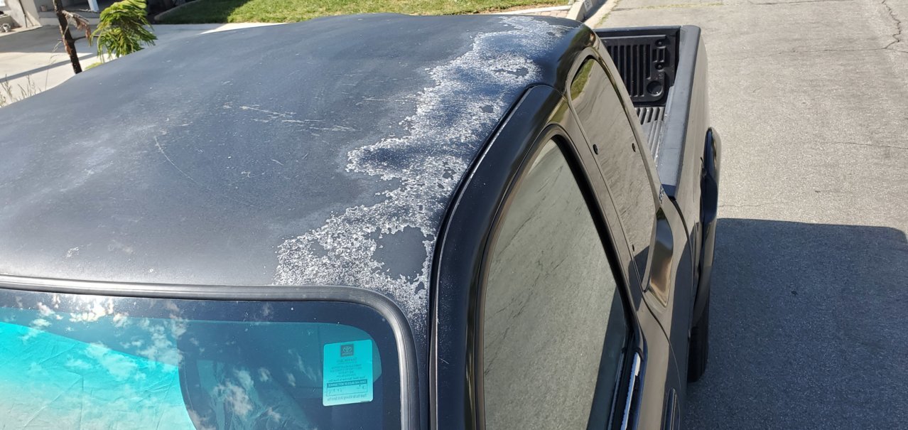

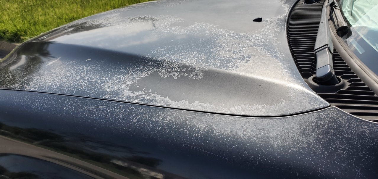

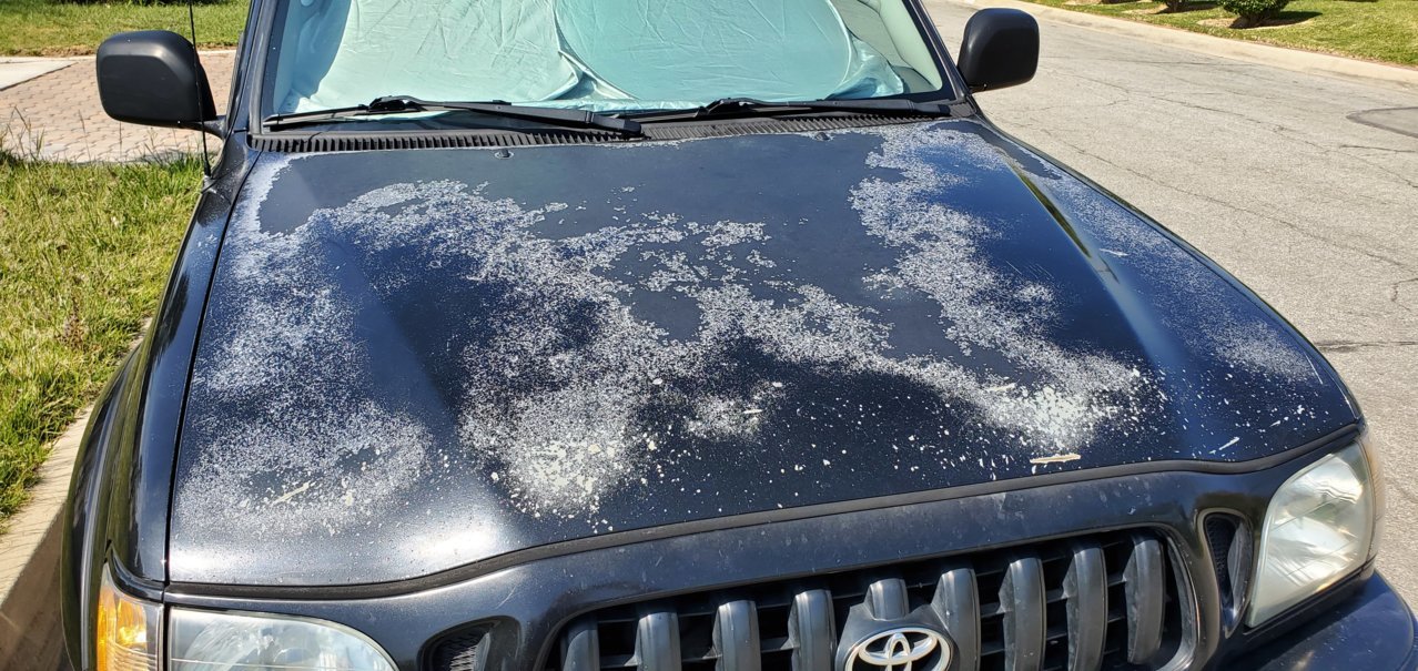

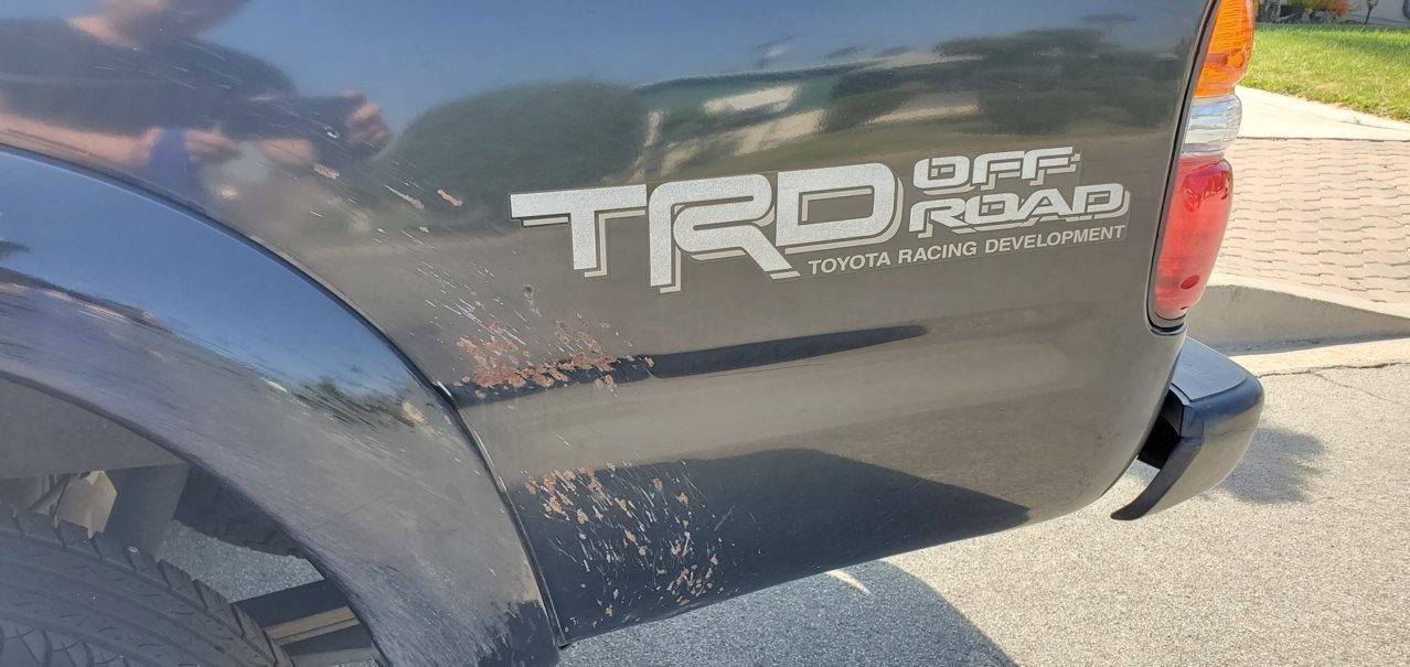

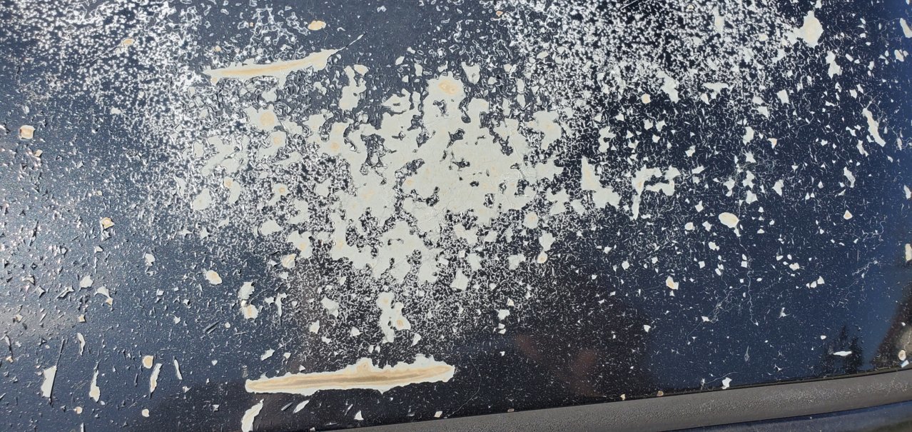

    i recently bought this 2002 tacoma with 285k miles on it and the paint on the car (mostly hood and roof is suffering pretty bad - pic below it seems the clear coat, and paint came off and it is down to the primer even metal in some areas). in addition i have some minor rust on the rear quarter panel from what it seems to be a minor side collision to something that might have scrape the paint off. its a work truck so i am all for maintaining it mechanically but don't really want to get a brand new paint job.
    any suggestions on what i should do prevent rust from spreading on the quarter panel as well as protecting the roof and hood from further damage is greatly appreciated.

    I've seen people paint just roof and hood. Your front fender tops will stand out a bit; might be able to blend them... I'd clean up the rust at the rear before it perforates. Sand/etch prime/paint.

    That's not really rust, that's more oxidation and peeling of the clear coat, allowing the base coat to peel.

    I meant left rear fender, accident damage. Fix it or at least POR 15 and top coat.
