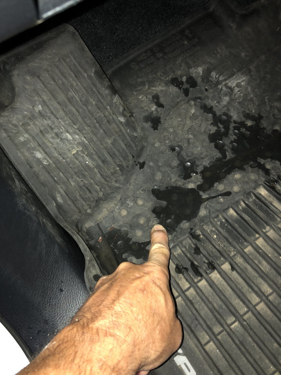

    Pennsylvania
    17 DCSB TRDOR
    The cab mount bolt is located here at the base of the foot rest...you can see the rest of it by peeling back the plastic wheel well behind the front tire. Stick a flat bar next to the bushing see if there is any play or compare it to passenger side should look the same.
