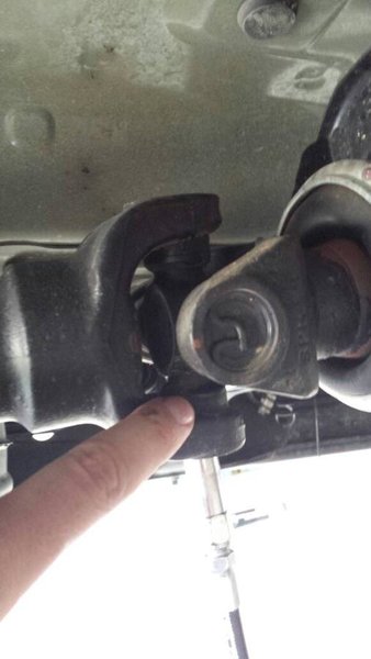

  15. May 30, 2014 at 11:26 AM
    #75
    cstallings
    cstallings Well-Known Member
    Mar 25, 2013
    #100538
    1,208
    Arkansas
    2013 MGM DCSB TRD Sport 4x4
    SOS Front Bumper, SOS Sliders, SOS skids, ARB Rear Air Locker, OME Lift (885x Coils, Nitro Charger Shocks, Dakar Leafs), LR UCAs, Leer Shell, OKLED 30" light bar, Wet Okle Seat covers, etc, etc
    Is the old grease supposed to come out where my finger is?uploadfromtaptalk1401474378870.jpg
  16. May 30, 2014 at 11:51 AM
    #76
    j0sh
    j0sh Well-Known Member
    Dec 30, 2008
    #12036
    275
    Oklahoma
    '10 TRD Sport 4x4
    AFE Filter, TRD Catback
    just greased my 5. And yes it comes out inside that area.
  17. May 30, 2014 at 11:57 AM
    #77
    cstallings
    Mar 25, 2013
    #100538
    1,208
    Arkansas
    Thanks...that is what I figured. I can't get it to come out. I think I'm having issues with my grease gun, since I'm not getting a good flow of grease. Damn air...can't purge it I guess.
