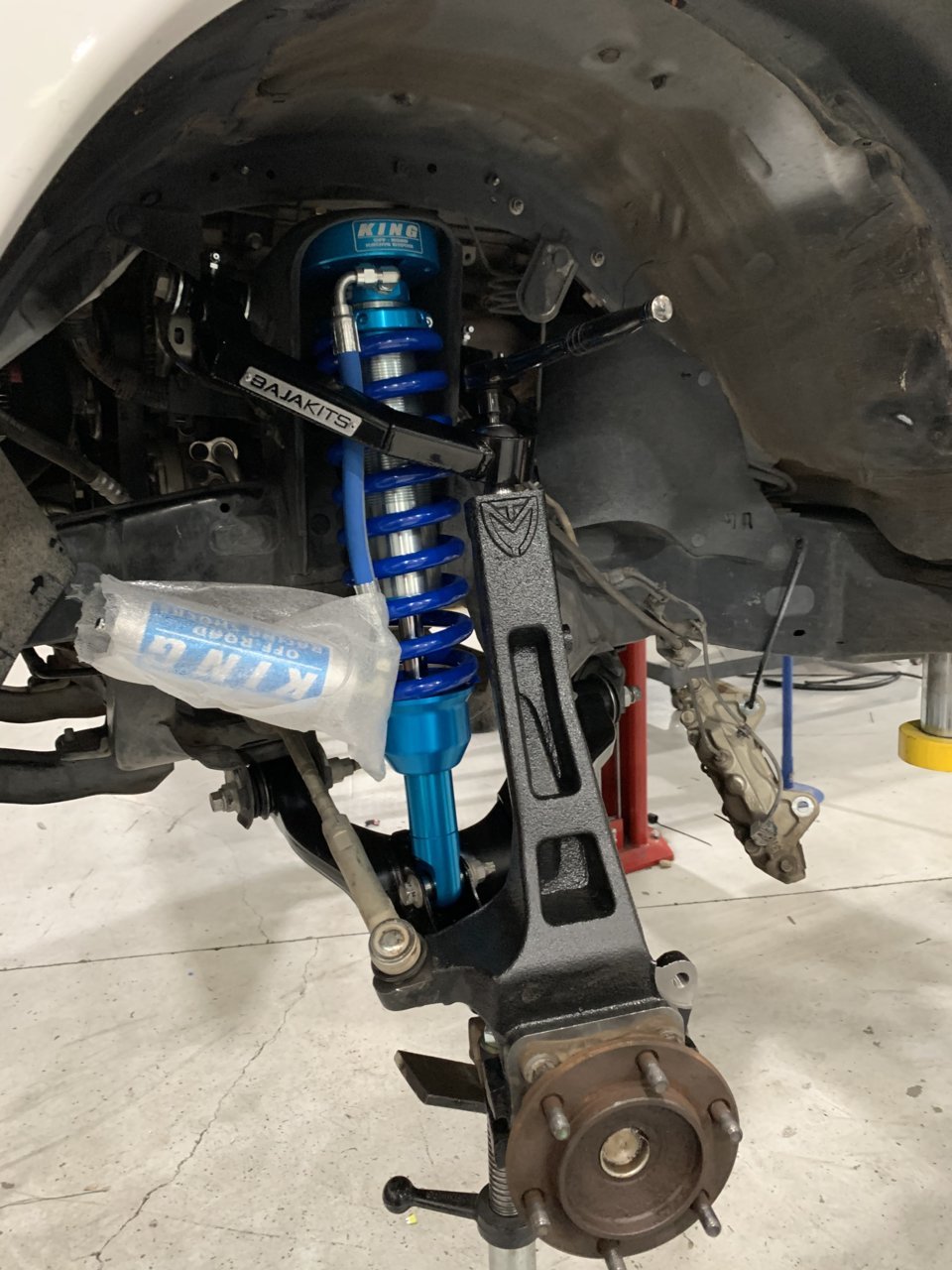

    Hi, I recently upgraded my suspension, I am running King 2.5’s with maxtrac 4in Spindle and bajakits boxed UCA. Everytime I make a turn , it feels like something is shifting up and done and moving around loosely in the suspension up front. I’ve had an alignment done, and everything retorqued and still feel it. Any guesses on what it could be?

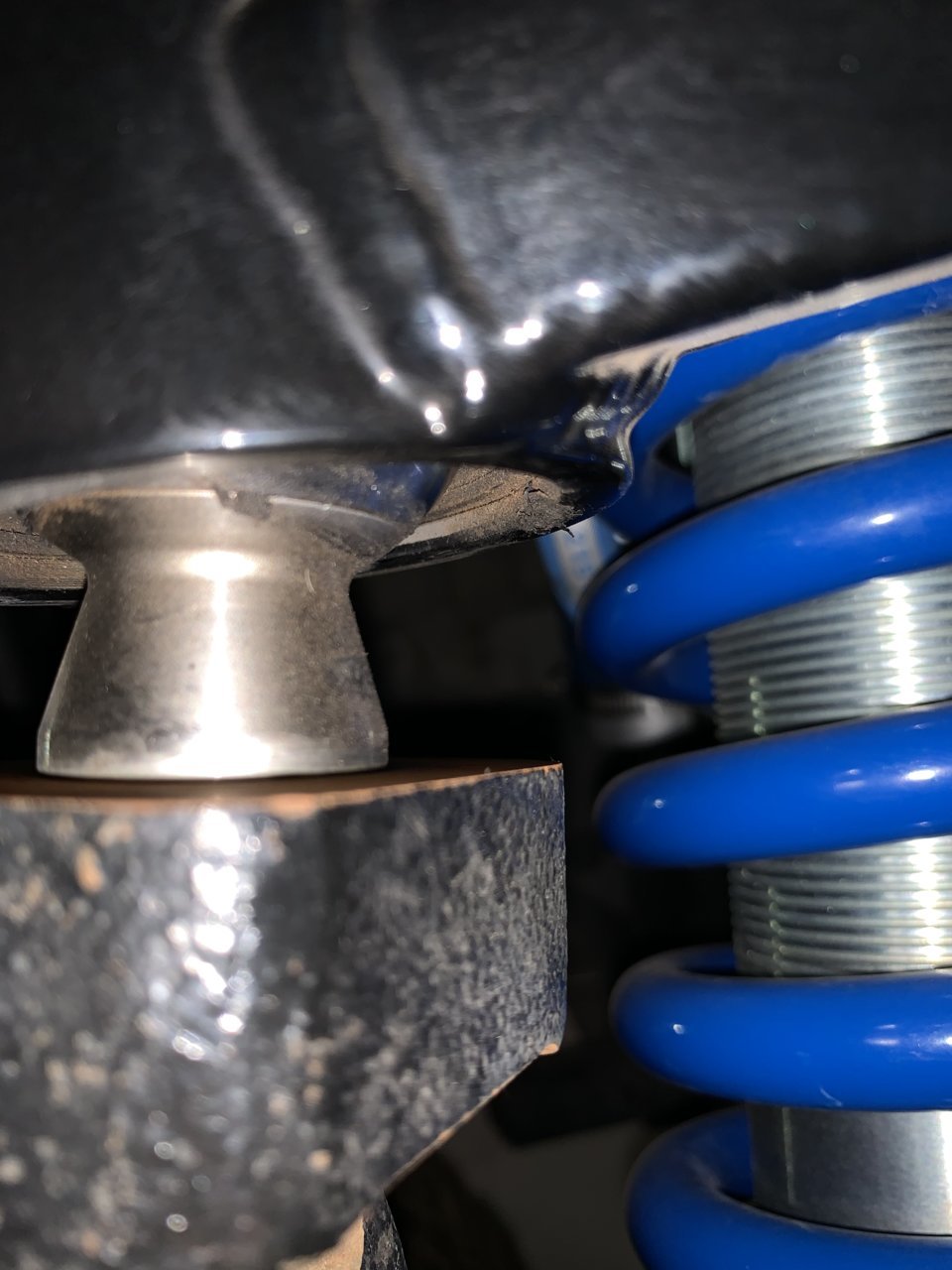

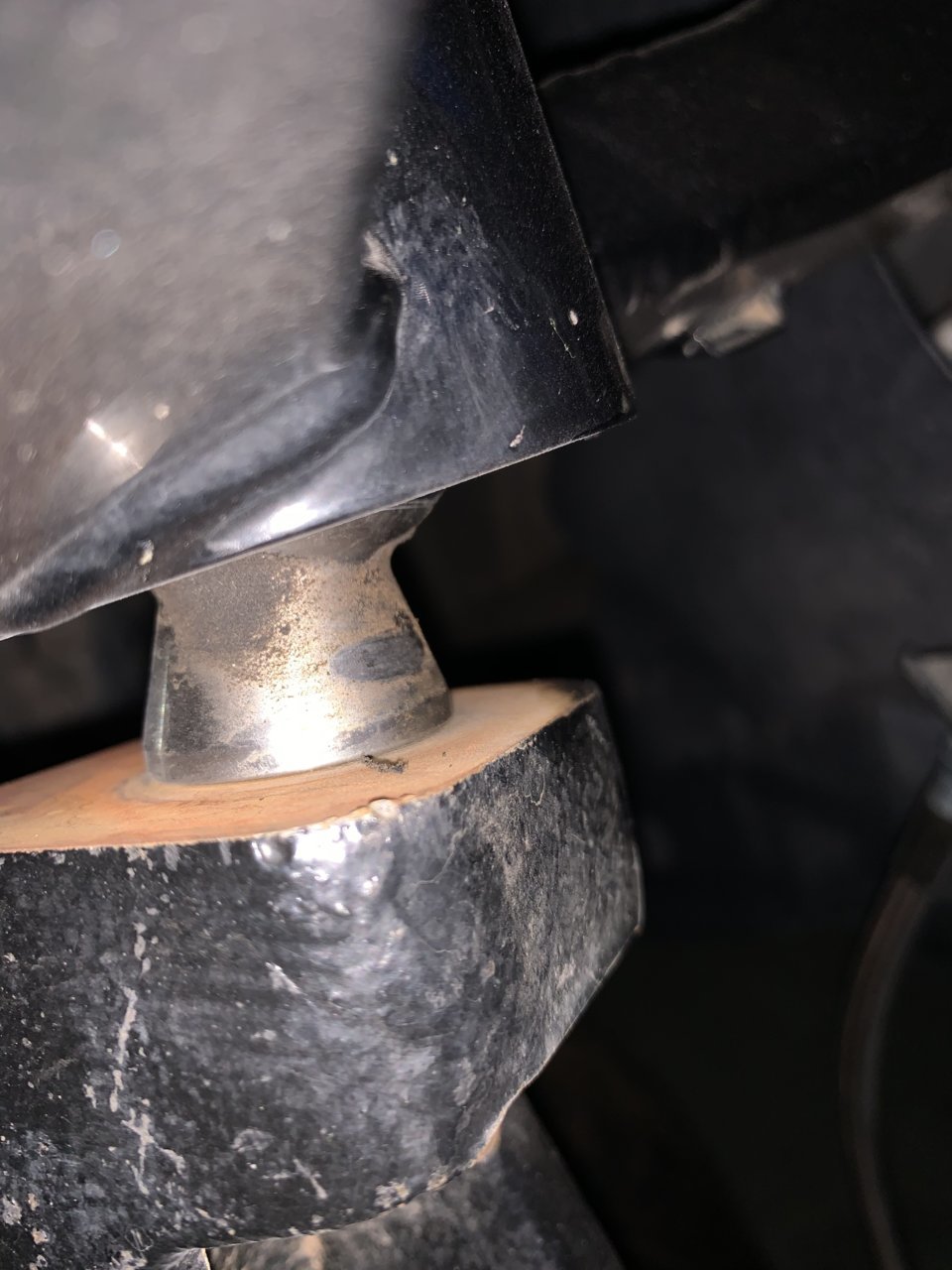

    This is when I cranked the wheel all the way and I noticed this rubbing mark on the housing, possibly this can be the cause of that shifting sound? Do I need a spacer or like the person above said shave that corner down??

    how many miles on the uniballs?
    judging by the first pic and the dent on the inside of the uniball cup the suspension in compressing to0 far an stressing that uniball.

    Sounds as if it could be the uniball but am I correct that they are new? If not they need to be looked at.
    The correct way to do this is to remove the spring and nitrogen form your shock and cycle the suspension and make sure you understand what is taking place. When mixing brands (UCA and spindle or anything bajakits) its really the only way to know what's taking place.
    If it turns out the up travel is too much for the uniball geometry as defined by the UCA you can raise your bump stop to limit up travel slightly.
