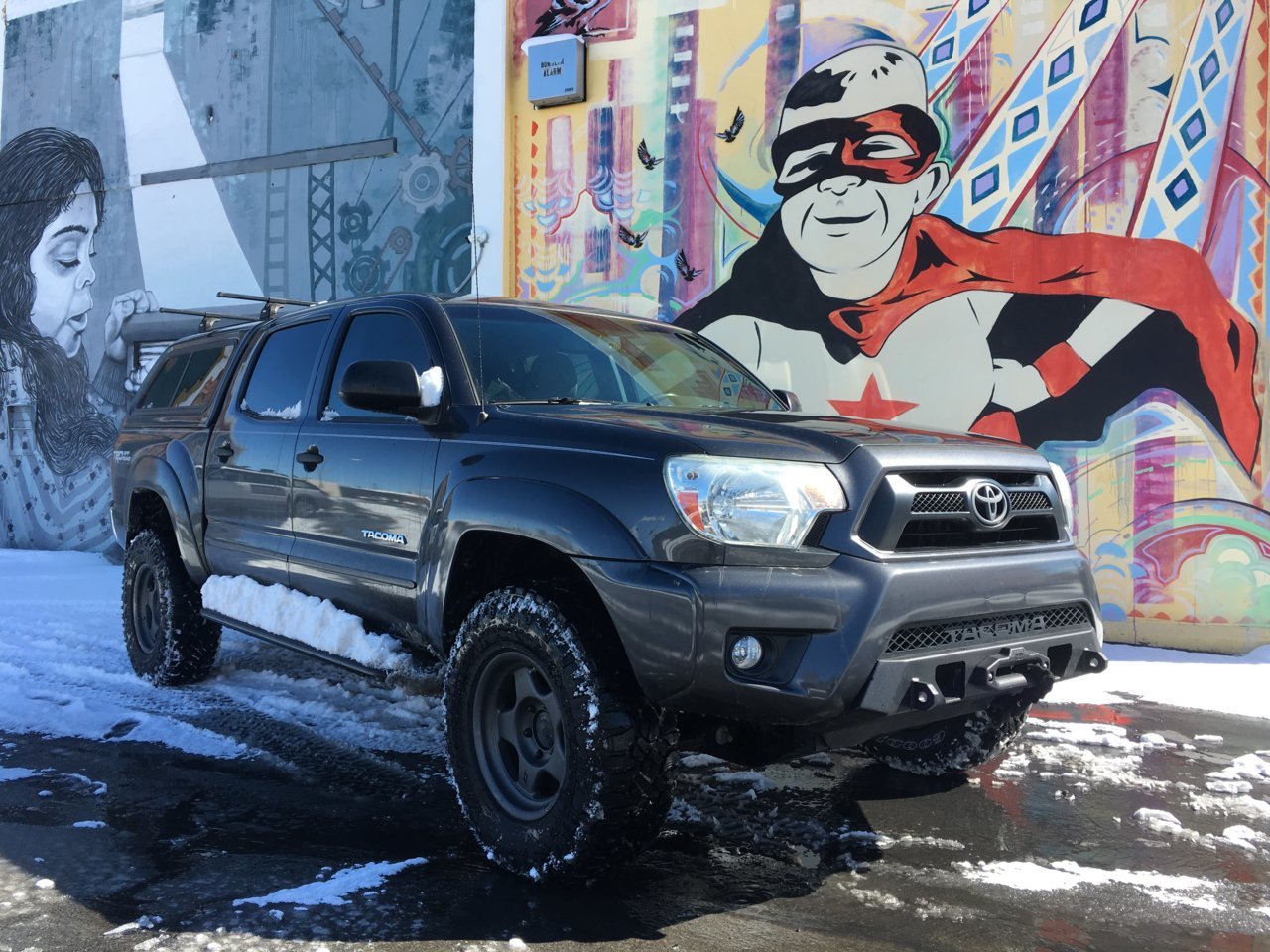

    I'm running the Fox 2.5 extended travel (883-02-025), SPC UCAs, and swaybar delete up front and the old style Dakar pack in the rear with the 3rd leaf removed paired with Fox 2.0 RR (985-24-118).
    What weight are you running that makes you feel you are going to need the 700lb coils and the HD Dakar with the AAL? That's not going to ride great unless you have a lot of extra weight. FWIW, I have skids, bolt on sliders with fill plates, rear HC bumper with a swingout, and a Relentless Fabrications Sting-Ray low profile bumper with a winch up front in addition to a shell and about 100lbs of gear in the bed and I'm happy with how it rides.

    BTW, damn good looking truck bud!
