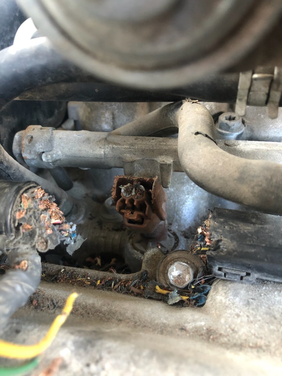

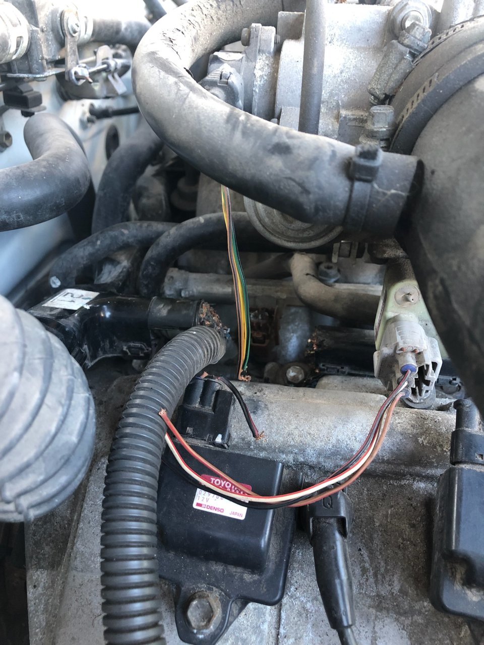

    My friend is just about to take a road trip only to realize a mouse ate his injector wiring and more. Anyone got a spare wiring to sell?

    That's not a mouse that's a pack rat:eek:
    You better catch him or move the truck somewhere else before you make repairs or you will be doing it again.
    If you do a whole harness you will need the part number from the old harness as there are many variations, if you don't have the part number then matching year, engine size, transmission, and if it's Federal or California emissions is your next best bet in finding the right one.

    Ouch. You can get a injector pigtail harness pretty easily. Maybe try a junkyard nearby to see if you can pull a harness, otherwise best case to peel back the harness and wire an extension to each color match. Soldering recommended.

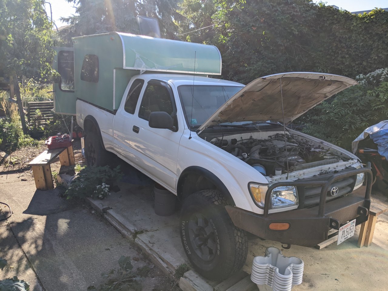

    Yeah sorry should've specified it's a 2000 3.4L V6.
    Feel terrible, has been working on his camper for a while but hasn't driven it in probably 6-12 months. Just getting ready to go to Colorado.
