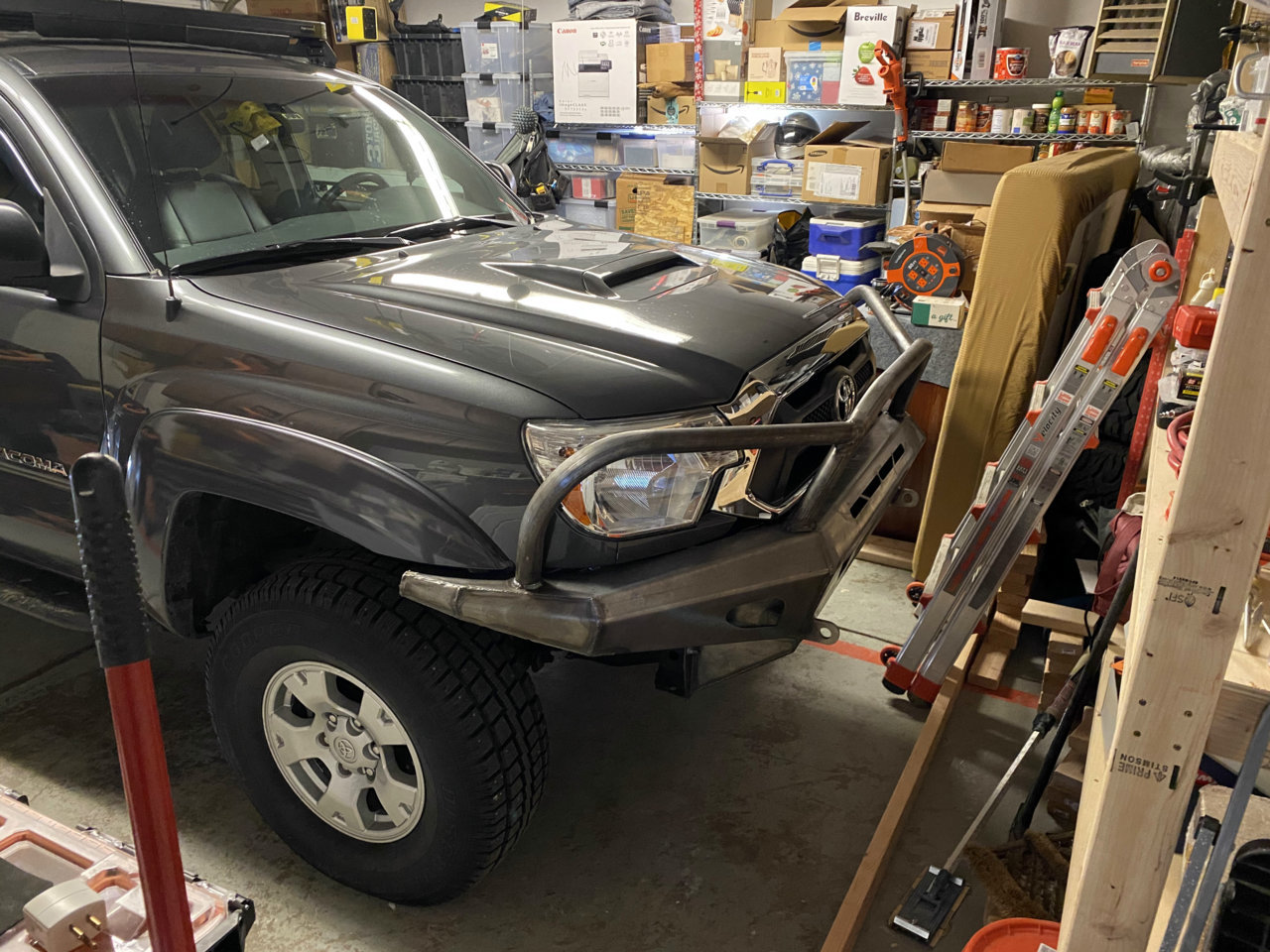

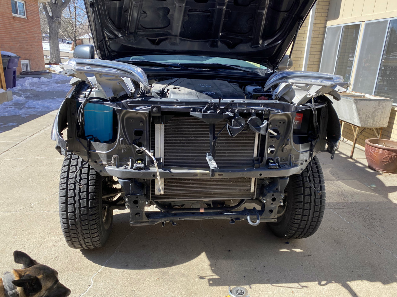

    I bought the SOS Concepts WIY bumper a while back, and finally got around to welding it together with a good friend of mine. Mine came with no instructions, and if it weren't for a handful of competing priorities and deadlines, I would have gladly embraced the puzzle! I had tried emailing a number of times prior, shortly after getting the bumper, asking for recommendations on winches, (but I can see now that the platform is plenty big for pretty much any winch) and I'd called a number of times to see what could be done about the missing instructions. Oh well, adapt and overcome. I think we did a bang-up job on it (major props to my friend). I got to try my hand at welding, and the angles and gaps of everything came out freaking sweet. He even welded the hoops the next day while I was at work. Without my truck as a reference, but he crushed it. Ok, enough bromance.
    The reason why I'm here is I've got a tentative trip coming up so I'm trying to hustle on the last bits. I'm in the process of grinding it down, and then I'm going to get it powder coated. I'd like to weld on what we're pretty sure are the foglight mounts, but I'm not sure where to place them, let alone which fog-lights to get. So here we are at my actual intent for this thread:
    Does anybody have this bumper, or feels familiar enough with it's kind to recommend a pair of fog-lights? I'm not looking to spend $1000 on fog-lights, but I don't see a reason to cut corners here. I was leaning toward Baja Designs Squadron Sport Amber Fog Lights, but IDK if that's the best option given the bumper and fog light cutouts.
    The spot for the fog-lights is kinda wonky-oval shaped, and at an angle towards the side ditch, so presumably I'd set them back a bit so they could point out straight. Not really sure why they had to be at that angle.
    Some pics (or otherwise none of this happened). That's my buddy Nate.
