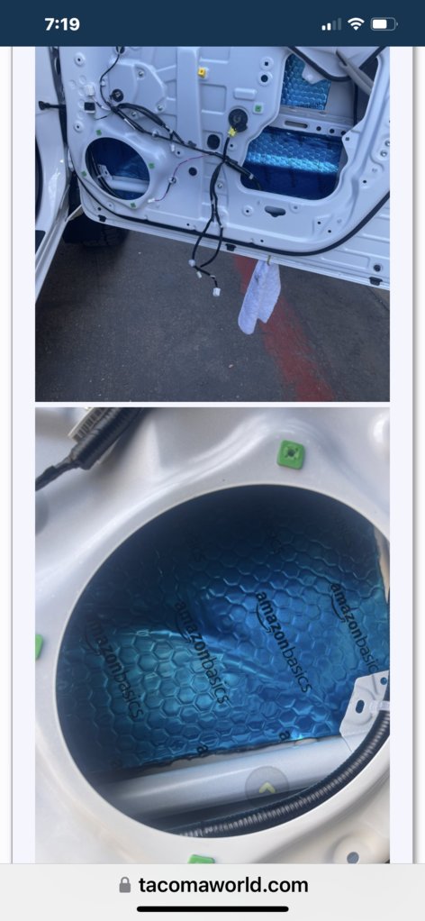

    If one of your hopes is that your factory non jbl sound system will sound better, dont think its worth the effort as it won't sound better....
    Does it improve road noise, absolutely but dont feel you will really notice, I didn't think wow sounds so much quieter...
    You do this if you're going to install a higher-grade sound system with actual amps, that's where you will get the huge sound system benefit....
    Your doors will feel more solid if you use the stuff similar to what I & fotofisher, & bobs world used, doors almost close themselves per se, but added weight.
    The hybrid stuff is lighter, less dense I guess, just different.
    Havent seen anyone in this forum as of yet to just sound deaden for roadhouse improvement in the off-roads, its all been sound system sound quality improvement / upgrade related.
    Would be nice here if im wrong.
    Its very easy to use a lot of the full sheets whole to do the outside skin, some situations I cut them in 1/2 long-way to fit in the tighter areas.
    Inner skin, the sound deadener material the butyl / foil kind, doesnt have to be installed on every inch of the inner door skin to see benefits of sound deadeneing.
    50% is fine, nothing wrong with doing it all but overkill from the characteristic of the product.
    Also inner skin is more busy & complicated in the topography dept.
    That's where the sound-skin hybrid shines in application to the inner skin, but won't get a sound improvement reduction compared to amz basic per the test results...

    Nothing wrong with cutting smaller pieces when needed, cuts easy with. just kitchen scissors...
    Doesnt have to be on every inch of the metal...

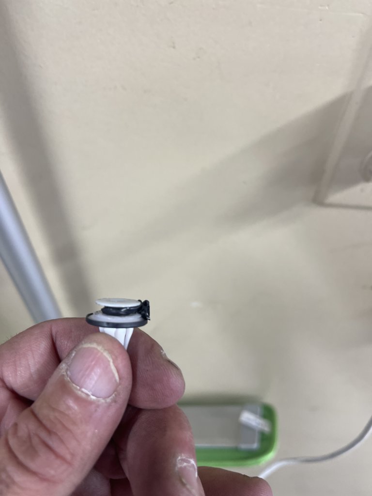

    I didn't understand what you mean by putting a wrap of electrical tape on the push pins. Are you basically trying to thicken them? Will they fit and snap in? Or did you mean where the base fits rather than where it snaps.

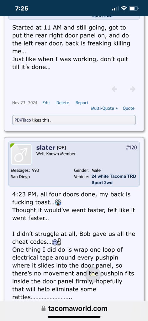

    The pushpins have quite a bit of slop where they slide into the actual door panel, to accommodate for variations.
    No need for all that slop and the electrical tape well tighten everything up, the door panels were reinstalled without issue afterwards.
    When the non-modified pushpins are in the door panel. You can wiggle them around over 1/8”++
    Most of them went back into the panel, just pushing on them with my thumbs,
    a few were a little harder and I just used a screwdriver to apply a little bit of pressure and they popped in place after the tape was applied.

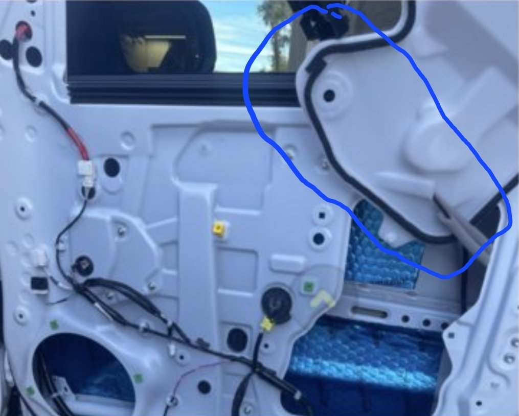

    From the link of photos that Bob provided, what is this part the he put the materials on? Initially I thought is is the back of the rear seat but I don't think so. I think is a panel that covers something because I see those push pins but also does look like a door panel, so do you know what that is?Screenshot_20241221_091700_Chrome.jpg

    It looks like you added some foam strip around the plastic piece.

    No, all factory.
    I carefully just bungeed the panel out of the way, felt there was no reason to pull the cables completely out...
    Im a less is more kind of guy, take a few pics of how the cables are orientated during assy,
    So you know which cable was on top & which was on the bottom.
    Probably doesnt matter much in reality.
    You can twist / rotate the latch handle mechanism & have it out of factory orientation if that makes sense.
    the back door has just thinnish clear plastic vapor barrier held in place by butyl tape.
    Just carefully remove the plastic vapor barrier from the door so you can get in there & install the matting.
    No reason to take it all the way off, just let it hand there, its just to get access.

    There is ABSOLUTELY no need to add tape to address the "slop" in the clips. The float in the clips allows for thermal expansion/ contraction as well as variation in dimensional differences between liner and inner door skin holes. It is wasted effort
    Unless you have a clip rattle, it is irrelevant to sound dampening. I work for an OEM and specialize in plastic interior/ exterior appearance parts. That is non-sense, no BS
