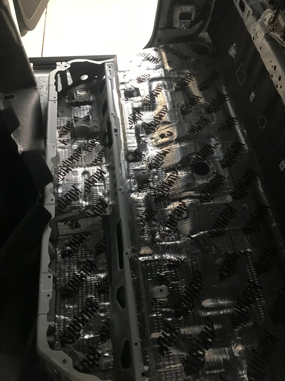

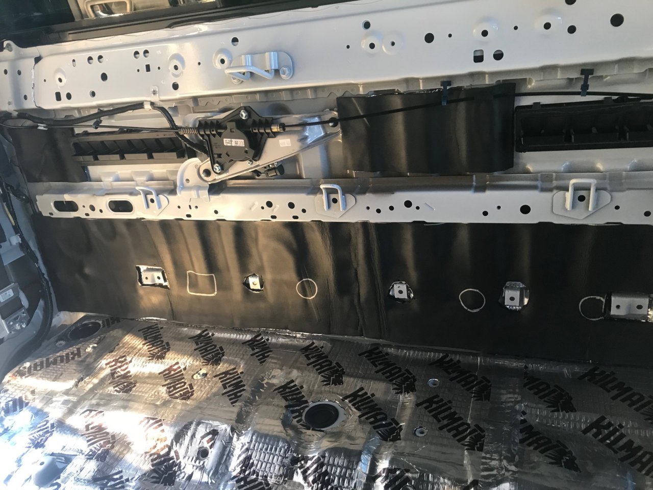

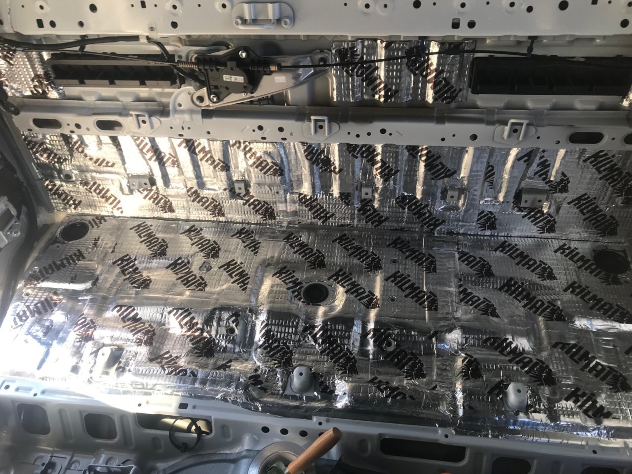

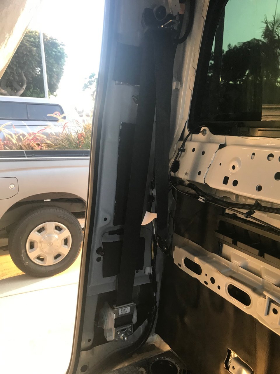

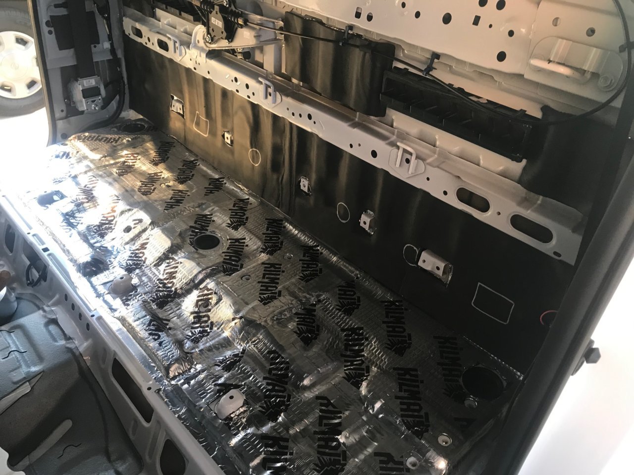

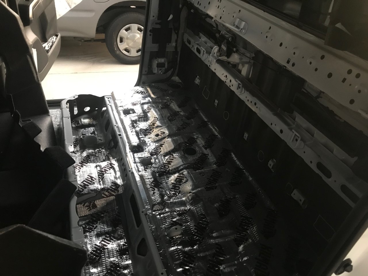

    So I started this project today, I had already done the roof since that part of the truck was arguably the hardest part to do. That was because I couldn't really take the headliner out completely without bending it or damaging it some way (I think there might be a way to get it out if you remove the center console but that's a project in itself). I plan to do the doors also not sure if I'm going to foam layer those also I think the deadening mats should be enough on there. Ignore the extra squares and circles I lined up the stock sound mat wrong then remembered that the foam I have reaches the whole length of the back wall. Not sure about the mat inside the under seat cubby but I figured that since Toyota put a couple sheets there then it couldn't hurt to layer it up. More photos to come once I get the rest of the replacement carpet padding. Links for the materials used and tools.
