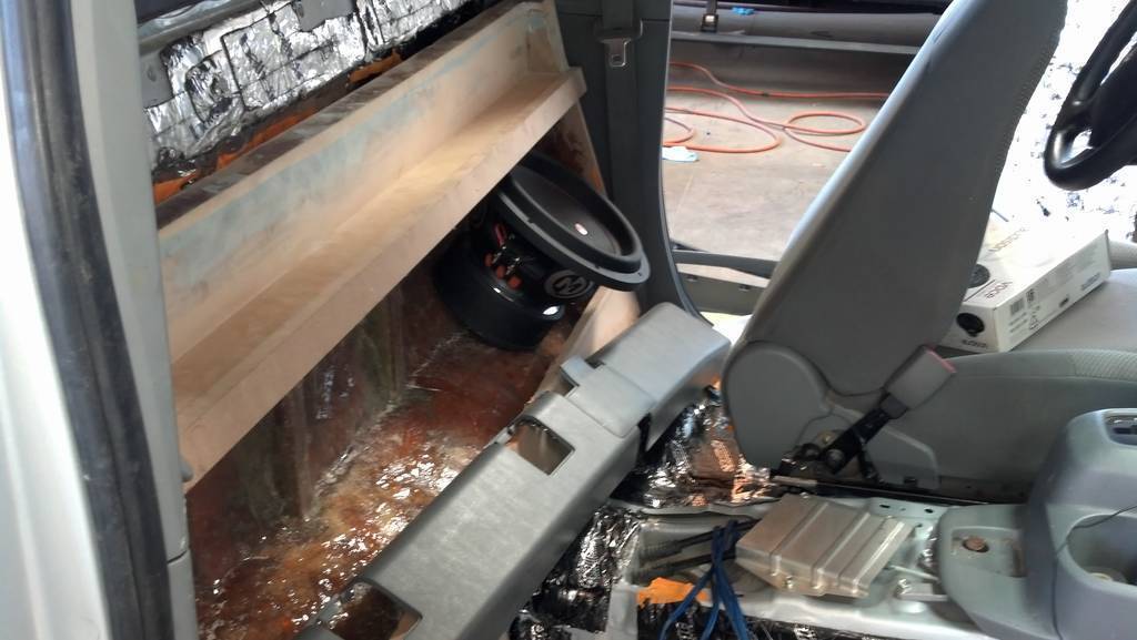

    King Remote Resi Suspension - Total Chaos UCAs - Full Katzkin Leather - Leer Camper Shell - Custom Projector Halo Headlights - HID Fogs - Eagle Eye LED tail lights - Rigid Industries LED Light Bar Mounted in Bumper - Wade In-channel Vent Visors - K&N Filter - 20% on the fronts - Dakar Progressive Leafs - Fuel Beast Wheels wrapped in Hankook Dynapro ATMs - 4 Tie Down Mod - Pop N Lock - Billet Grille - Weathertech Mats - LED Map and Dome Lights - Optima Yellow Top - Redline Elite Hood Struts - Tunes: Eclipse 7100 HU - Eclipse IPC-106 Interface - Audison LRX 5.1K - Hertz Mille MLK2 Components - JL 13TW5 - JL cables and wires - Fully Deadened with SDS products - Metra dash kit - Custom Sub Box and Amp Rack - Still Under Construction.
    Do it.
    I did the whole cab, including the ceiling. An extra pair of hands would have been nice, but it can be done alone.
