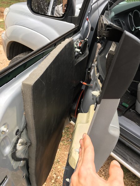

    I had some leftover soundproofing material from work
    Loaded vinyl with peel and stick on one side
    I decided to try and put it in in the driver quadrant I would take pictures for anybody considering this
    If you do then I would go with a thinner material for the sake of getting your door back on

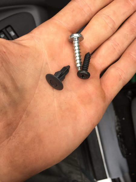

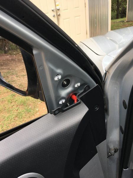

    The black plastic triangle by the mirror Popped right off
    Under that was the push button plastic anchor clip
    One screw behind the door handle and one screw behind the grab handle were both accessed with a small flat head

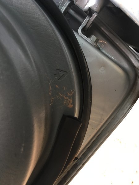

    From there I pulled the panel starting from the front bottom corner, be sure not to lose the little soft rubber washers around the clips that easily fall off.

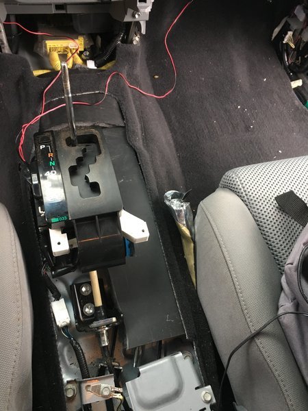

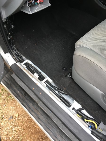

    Carpet and center console access is pretty self-explanatory, pop off the trim, remove some staples
    I cut a 19" x 34" piece for the driver-side carpet stuffed it in and buttoned it all back up
    Two screws at the bottom of the console and two at he shifter then cut some pieces that fit in there.
