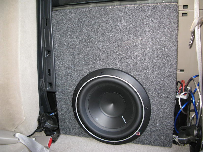

    Had the B-8pt, but returned as I wasn't satisfied with the sound output. I went with a 300W setup instead for ~$150 more:
    SuperCrewSound DC enclosure
    Rockford Fosgate P2D2-10 Woofer (10" Woofer)
    Rockford Fosgate PBR300x1 mini amp (300W Amp)
    Packed in ~12oz of poly fill.
    I agree the B-8pt is pretty good for the price and size. The above setup still won't wake the neighbors but does sound better at higher volume levels and seems to fill a wider range of the bass spectrum clearer at higher volume levels. The difference is noticeable particularly when driving freeway speeds. It is ~$150 more and if you don't mind sacrificing a little more space and got some free time building your own subwoofer.
    Update: Several weeks later after reading about what Polyfill can do- I went ahead and added in about 12oz. (Polyfill is sold at Walmart for < $5 per 16oz at the crafts section). Polyfill is supposed to make small sealed enclosures think they are 20-30% bigger. The result after I added the polyfill: The very low end of the spectrum sounded much, much, much more defined, tighter, cleaner and louder. The system now has bass that you can really feel and will definitely shake your mirrors if you keep the gain and volume up too high.
