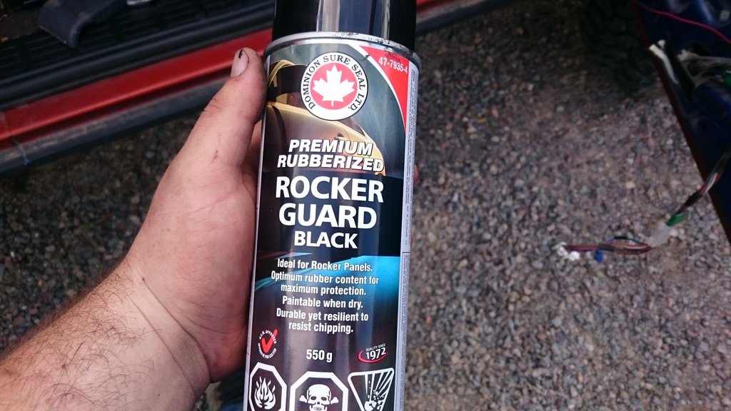

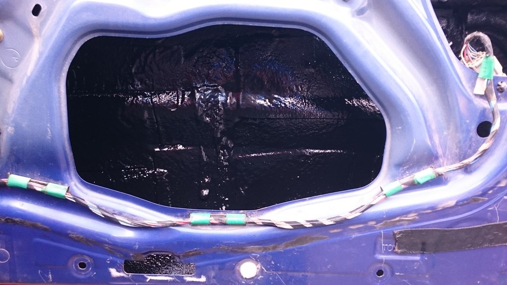

    I used a full can of rubberized undercoating along with a bit of 3m sound deadening mat. in one door and worked great. Gota do the other tomorrow. th_MOV_0019_zps1eysroao_d473cfddc665fe5083489dbd494ddcd2a5e3ad8d.jpg

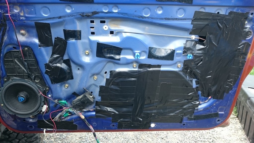

    I used tape to completely seal off inside of door with cardboard in between layers.

    When i was driving around with only one door deadened the difference could be heard pretty good. It mostly blocks out the noise of the front tires which is a good thing when your running mud terrains...

    I put the rubber holding vapor barrier on each one so their snug.

    The peel and seal is asphalt based and it can smell pretty bad for the first couple weeks and on hot days after. Besides the smell it works in the same manor.
