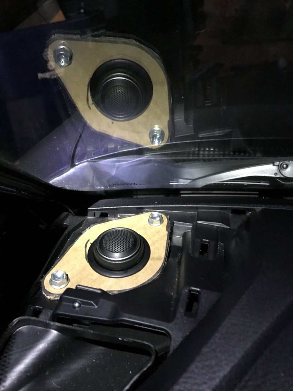

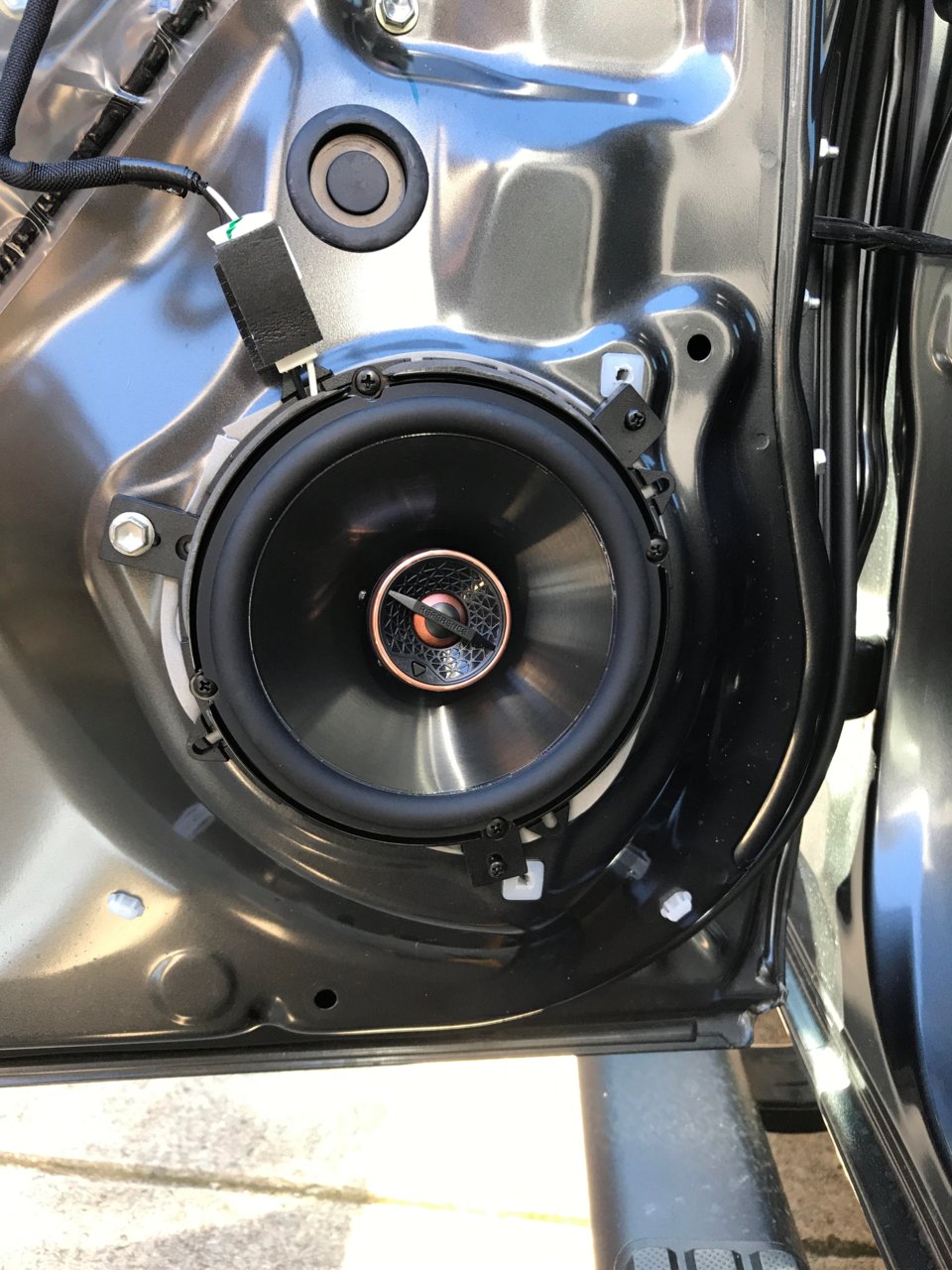

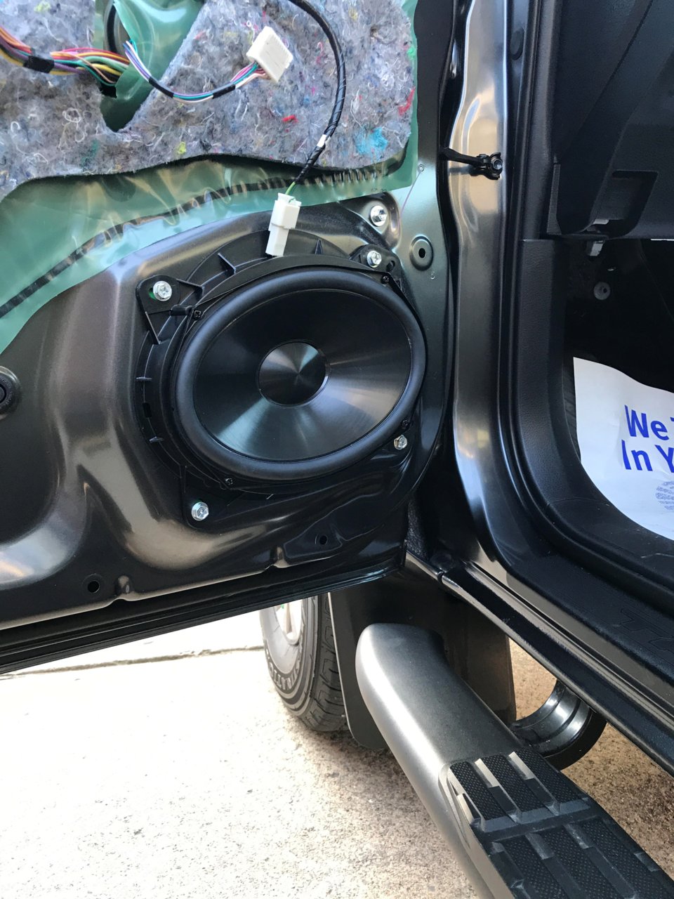

    I installed Infinity reference 6x9 components in the front (https://www.amazon.com/Infinity-REF...8-1&keywords=infinity+reference+6x9+component) and Reference 6.5s in the rear (https://www.amazon.com/Infinity-REF...082434&sr=1-1&keywords=infinity+reference+6.5). Not quite the plug and play scenario the people on here seem to prefer with the Subaru Kicker tweeters, but I never stray from infinity and install wasn't very difficult.
    All in all, around $200
    Insane upgrade over factory sound and significant bass from these 6x9s, even without an amp.

    Careful running infinity speakers on factory amplifiers, their impedanceis lower causing shorter life span.

    Yes, it's built into the radio. They're designed to push a 4ohm load, most infinity speakers run 2.5 to 3 ohms.

    Yeah these pull 3 I know. Is that not one of the selling points, though? Lower impedence = more amps to the speaker? or is that your point that pulling more amps than the stereo can handle is bad for it.

    Lots of variables into longevity. But yes, a higher current draw from a radio than it was intended for is not a good thing.
