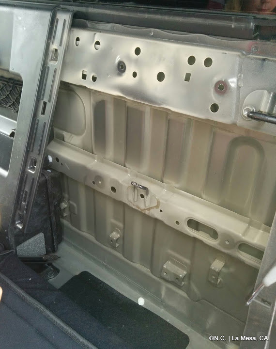

    I'll tell you my plan. I'm going to do something similar to the OP Instead of applying open-cell foam seal to both sides (door and jamb), I'm just doing one side, probably the door. I carefully measured the gap between the drivers door and door jam using my daughters play-doh, sans modeling clay. :D Worked great! I measured in three places, appears to be a 3/8" gap all the way around, so using a 1/2" "D" seal is a good idea, IMO. I've requested a few different samples from a national manufacturer of high quality EPDM seals with 3M adhesive. I think they may arrive next week. Once I'm happy with the seal product, I'll purchase in bulk and do all the doors.
    I recently pulled one of the panels from the rear of my truck and I couldn't believe how much dust was in there.
    Check it out:

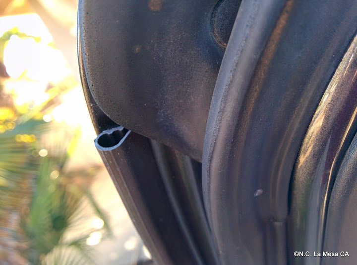

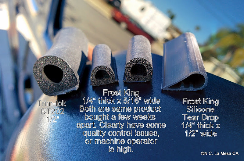

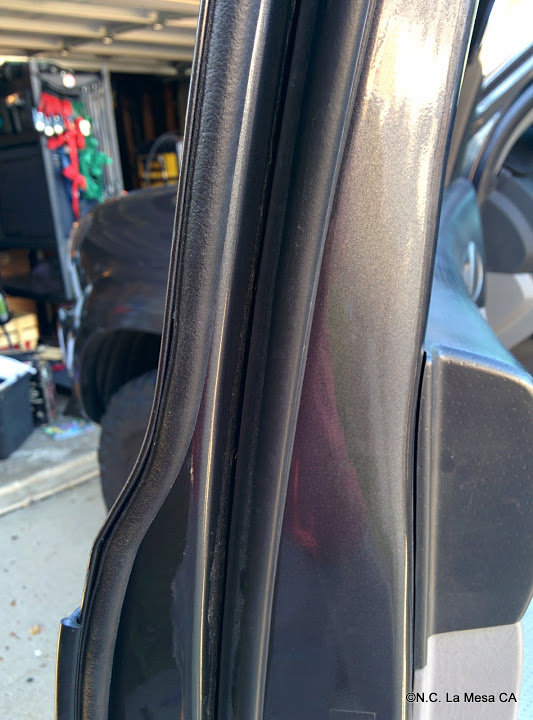

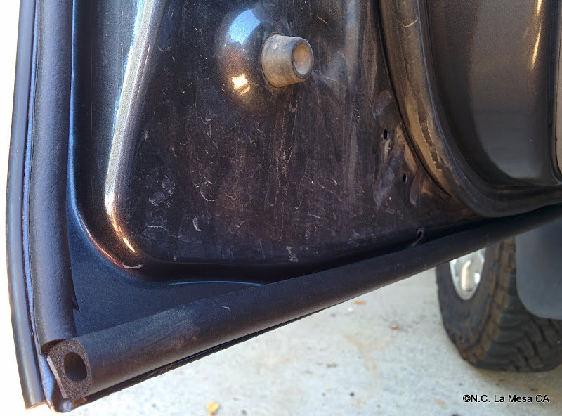

    Okay here is what I can tell you.
    It takes a lot of trial and error to get this right. Too much new insulation makes the OEM seals no good, so a careful balance must be found.
    Also, there are irregular surfaces and tolerances that are different between the doors so what works on one door may be off for another.
    But in a nutshell, what I did can be used as a guide, just like the OP in this thread.

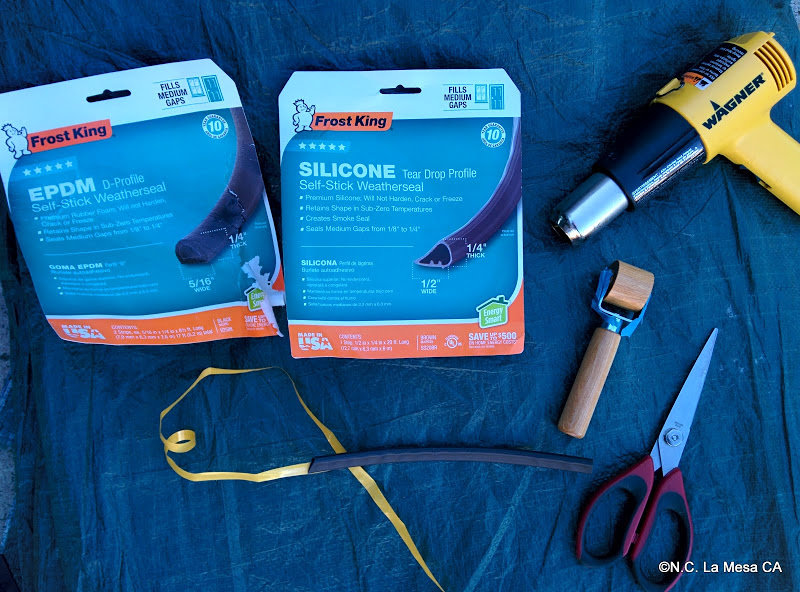

    Also, there are two kinds of adhesives sold with seals. The 3M stuff which is great, and acrylic which is not so great for automotive use. The seals with 3M are much more expensive. I have about $70 into my seal project.
    Heat gun was helpful, and sound deadner roller.
    I used the 1/2" Trim-lok seals on the bottom of all the doors. AND the 1/4" EPDM on the front door edges.
    1/4" EPDM seal on front door edge.
    The pear shaped stuff was used on the door edges for the REAR doors.

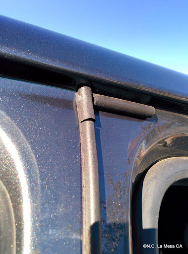

    I also used the 1/4" stuff on the B pillar, and I had to reinforce the OEM seal as it was deforming. The piece that's horizontal in the photo is doing that.
    There is a noticeable reduction in wind noise. I'm still going to do the foam rope shit on the windshield once I can find it. My stupid home depot only has the 3/8" stuff.
    Like I said before, lots of trial and error! One really helpful tip is to cut 1" test pieces and apply them on the front door, then open the rear door to observe the collapsed profile to make sure the seal is doing its job.
    Thank you Warren Thompson for your idea!

    crom im curious as to why you used the teardrop seals on the rear doors instead of the D shaped foam
