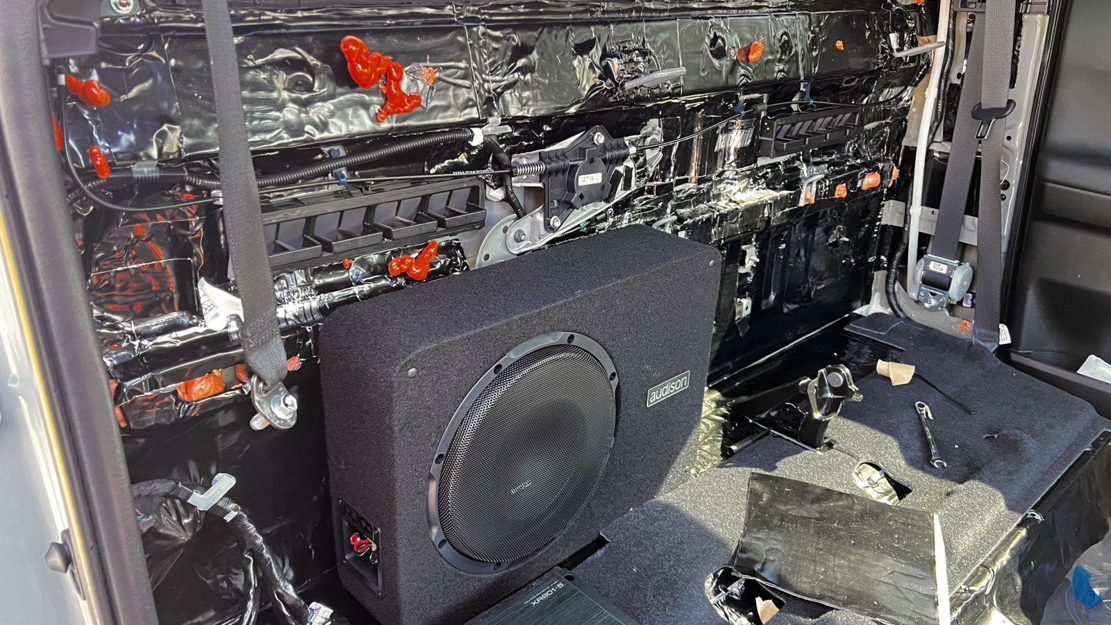

    But if you really want to quiet the cab down, get your hands on some open cell foam (like the kind they put in Pelican Boxes) and cover the rear vents with the foam. No air pressure issues when closing the doors, and it knocked cab noise down tremendously......

    Very nice job. Where do you find the foam for the vents?

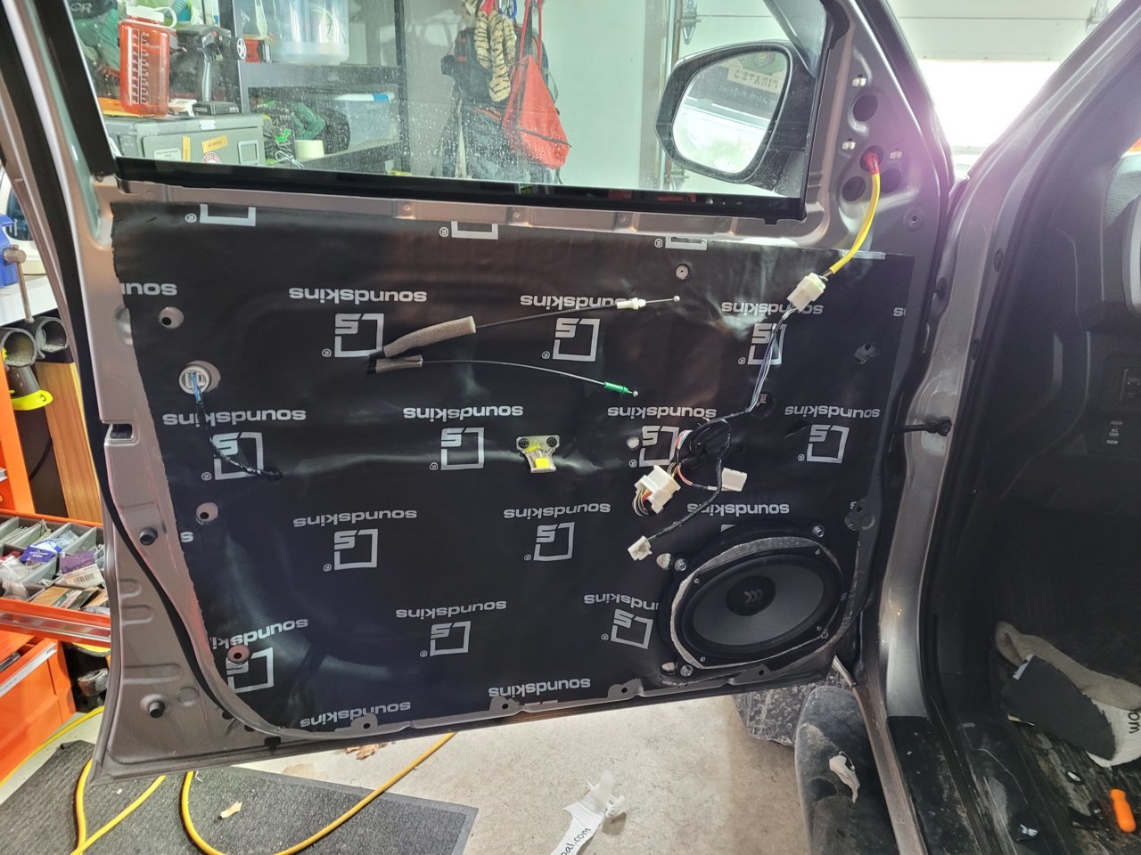

    Spent last weekend tackling that job. I already can tell a noticeable difference in the amount of road noise that has been blocked out, as well as the speakers now seem way more crisp.
    I also went with the Sound Skins precut panels and will be installing those with the speaker rings this weekend once weather clears up. Oddly enough the speaker rings didn't ship with the foam squares like photos show, but I'll just pick up some off Amazon to place behind speakers and rear cubby panels.

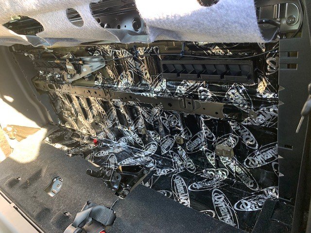

    This is what my back wall looked like after I was finished. Did you do yours similar?

    You did more than I did lol

    To be fair I did do this part first since I knew whatever material I had left over would go into doors. They Dynamat kit actually covered the back wall and all 4 inner door skins minus the support bars/rails. I actually had enough to cover large chunks of the inner cubby panels and front door cards after all was done.

    :yes: I finished it haha. I wanted to share some honest feedback so whoever else wants to tackle this install some notes might help. As @CoastieRon stated it's very helpful to have an extra set of hands to get the panel lined up. My panels specifically didn't line up as cleanly as I would have liked, but I did make them work. My main issue with the product was the backing paper was very unforgiving to remove off the panel and took a lot of time to get all the tiny parts off so the adhesive would stick.
    Overall I'm pleased with the performance of the panels as the road noise has significantly dropped. These with the addition of Dynamat on the inner door skins has made for a much more comfortable interior and driving experience. I would give them a 8/10 just based on the issues of panels needing "massaged" into place and the backing paper being stubborn.
