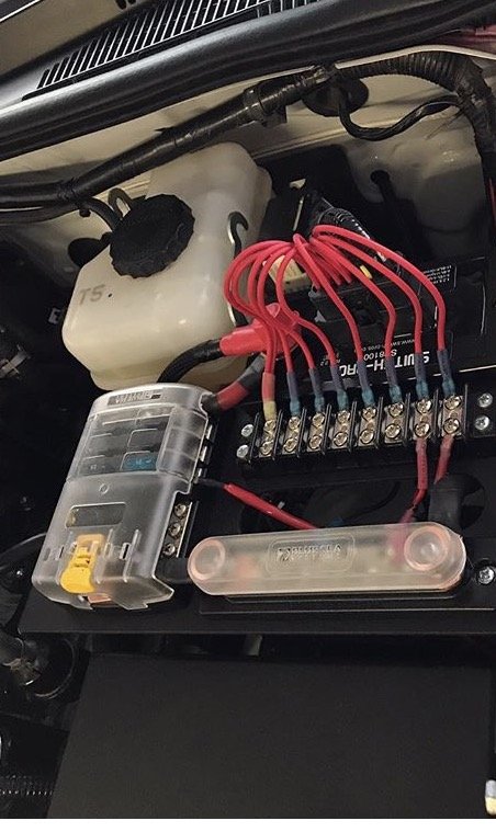

    Blue Sea fuse panel, 6g wire directly to truck battery. I also have 2 Trojan T-105s in the bed with an A/B switch. A 200w solar panel on the roof rack runs fridge 24/7 and keeps battery charged.

    Sweet install! Blue Sea makes some good stuff.
