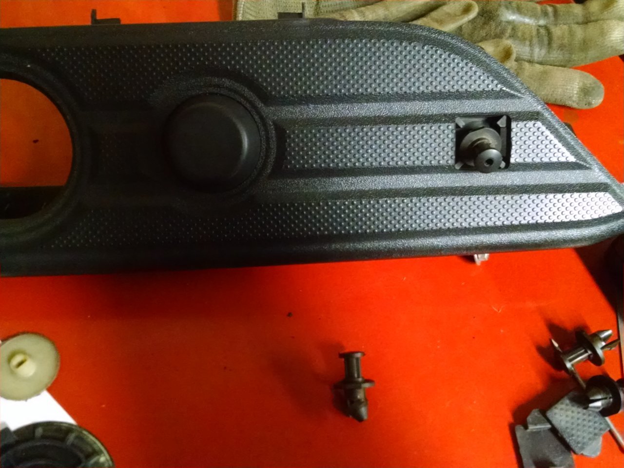

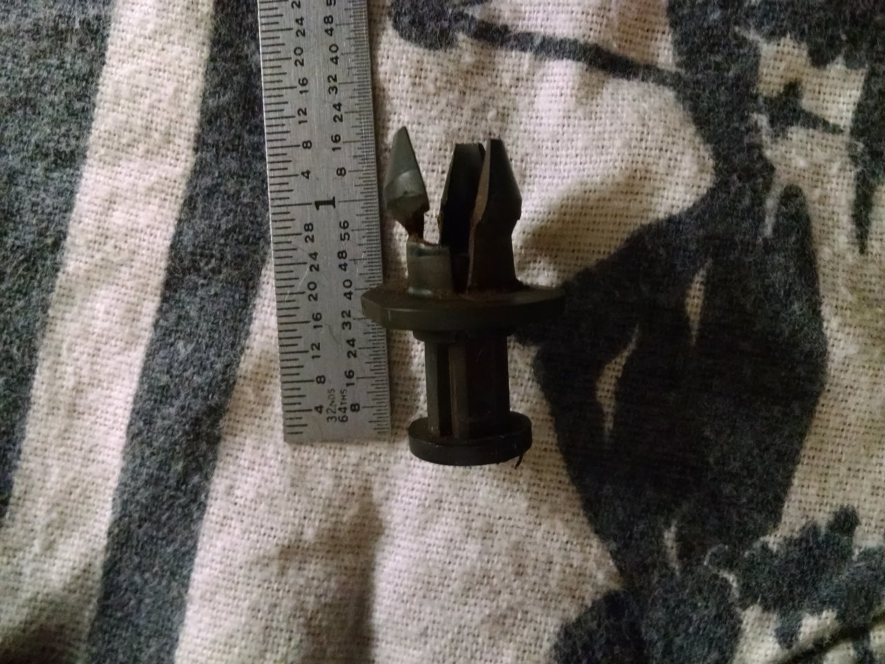

    I am trying to find a source to purchase these as the dealer does not list them or has a p/n. No one locally has a clue and I have been on line trying to match. No luck. Has there been anyone else that has replaced these 4 pins that can help me with a P/N? It is on a stock 2005 tacoma. Thanks

    No, it is the four that hold the cover on see photos. I hope this works. Thanks

    OP, check your manufacture date on the LH door pillar.
    Up until 05/2005 the pin is a two part affair: 90109-06325 (post), and 90179-06328 (bottom)
    From 05/2005 to date it is a singe piece: 52161-04010
    The dimpled square-shaped cover piece is 52169-04010
