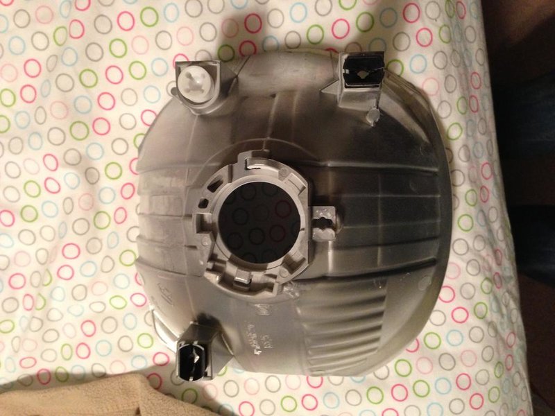

    There is only 2 torx screws holding it in right? And I think it just pulls apart.

    Does the screws follow "lefty loosey righty tighty"? how will i know they are loose :eek:

    Yes they do. You can see where one of them goes through the rear of the bowl, after that one is all the way free you will be able to tell by lightly pulling on the bowl when the 2nd is free. When you get them both out there is a ball and socket that you will just have to pull like hell to separate.

    The white part is the socket. The two black ones are where the adjusters thread in.

    Fucking hell this ball thing is annoying as fuck...
    >_>
    Got the bowl loose just trying to get this last thing off...
    EDIT: Fucking hell. i got it off. :D
    Now for the other headlight....
