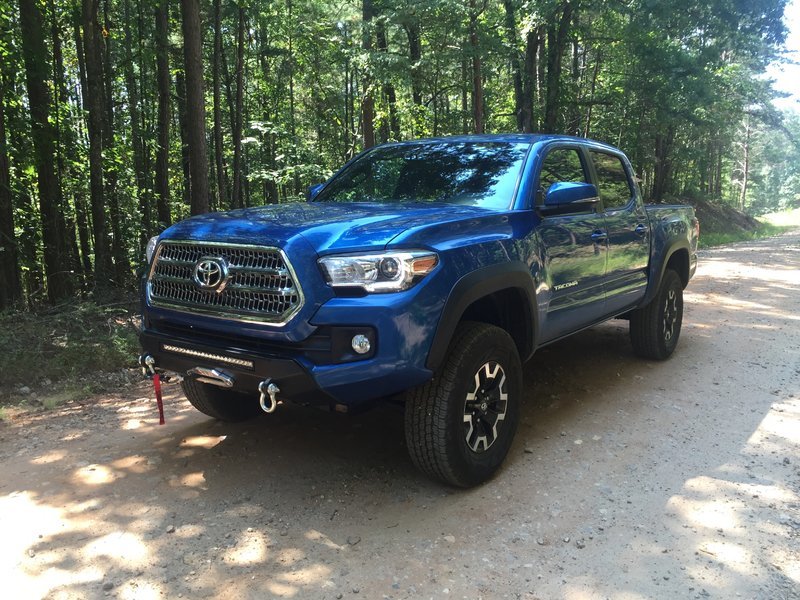

    I paid a shop to install it, and they were scared to cut too. I ended up having to make the cut myself. I was nervous too, but it ended up looking great. It's a very simple cut. I used a diamond blade on the Dremel. Couldn't find a rip one that they recommend.
    Also, I will note that it squatted down the front about 0.5" (and I didn't even like the rake before that :)) so I ended up doing OME 885 coils with 5100's set to 0, and it's absolutely perfect now. Rear sits only about 0.25" higher than the front.

    It's the Smittybilt XRC 9.5k Synthetic that I had on my old Jeep. But, Kevin recommends a wireless one and I would second that. In order to access my plug port, we had to cut the bracket behind the grille and then reinforce it. If you went with a wireless one, you wouldn't have to do that.

    I just mean that adding the 80lb of the bumper plus the 75-100lb of the winch makes the front ride a half inch lower.

    You're adding 150lbs to the front of the truck, 1/2" isn't really that bad.

    No difference in the ride after the winch/bumper. I installed the coils/shocks about a week after.
    The new coils and shocks did make the off road/rocky ride smoother than before though, but that's not really related to the bumper.

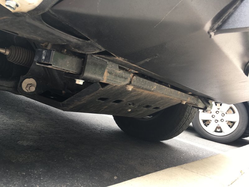

    Here is the bumper with an RCI skid installed. I think I'll have someone manufacture a connecting slide between the skid and the bumper so I don't get hung up on that "step.file7.jpg "
