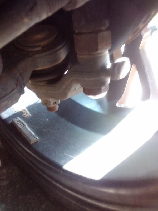

    im having a hard time loosening the bolt can anyone help??? i tried taking the bolt of,but seem like it on there for life... also when you put these on do you need a aligment right away??? i was gonna get a 1" spacer, but what the max you can go with the djm arms and the xr stock springs????
    what it takes
    4 bolts 1" longer then you stock spindle bolts
    4 nuts 1 size larger then the bolts (to just slide around the new bolts w/o play but not threaded on )
    8 washers the size for the spindle bolts (one on the top and bottom of the nut/spacer)
    edd23099_dea30b4d695a9fe2099f6588fd5cb7ec94f5d2d2.jpg[/QUOTE]

    which one the castle nut in the middle or the two on the side?

    the two on the side???? if looking from the botto, turn left to loose right??? im gonna need a impact gun or nooo???

    just go at it with a breaker bar. i think its tourqued down pretty good to like 80 or 100 ft lbs or so.

    any updates on this? I was thinking of doing this but don't know the bolt size. The OSH were down the street from me has a bunch of grade 8 stuff.

    this is what I got from CT but it is regarding a lift kit
    "2005-2007 Toyota Tacoma 4” lift spindle from Allied Motorsports. This spindle maintains stock suspension and steering geometry and we are planning on making it compatible with any manufacturers long travel kit. (We will be test fitting a set later this week) It will work with any UCA or bolt-in lift coil over. The biggest upgrade from stock is that now the lower ball joint plate is in double shear by two ½” thick tabs with 5/8” bolts, whereas factory is a single shear blind thread with 14mm bolts. The ABS sensor is relocated from the side of the spindle and placed on the top with its own access pocket. The caliper tabs are machined into spindle, they are not welded on. There is no cutting or grinding: the entire system is bolt-on. A longer brake line will be needed to run this spindle. We are looking to have a March 2007 release date and are taking pre-orders soon. Call or stop by for more info."
    I am going to see if the 14mm socket will fit on my OE spindle bolts, hopefully that will give me more of an idea or maybe what kind of bolt I need.
