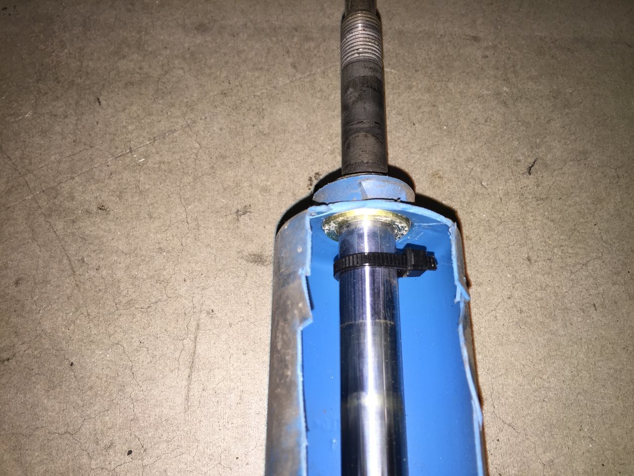

    Here is how much shock shaft is left with a 1” spacer on a 2gen Tacoma/Trd shock with the trucks weight resting on the bump stop. As you can see there is still room to spare even with a 1” spacer.
    People run into problems with the 2.5-3” spacer lifts and I don’t argue that, but people also break/bend 5100’s and Icons with no spacers involved.
