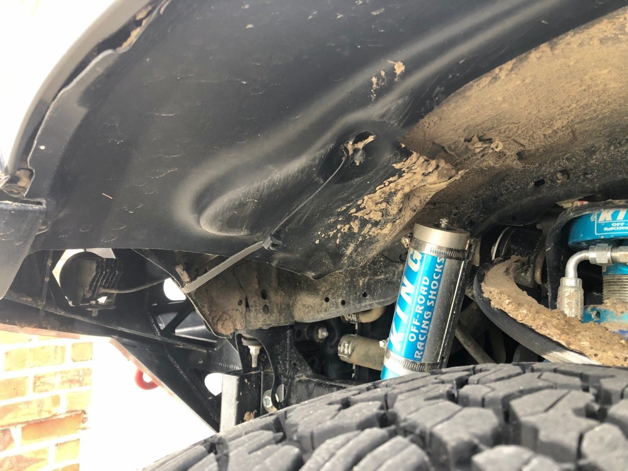

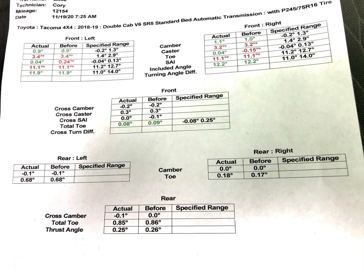

    You're correct that R17 was a fat finger on my part. They are R16s. I am still trying to work out the rim width, which unfortunately is likely going to require breaking down a rim.
    My rubbing is not on the cab/fender as far as I can tell but, on the UCAs and Rear shocks
    See photos for the latest alignment and current fender trimming. Sorry for the confusion...

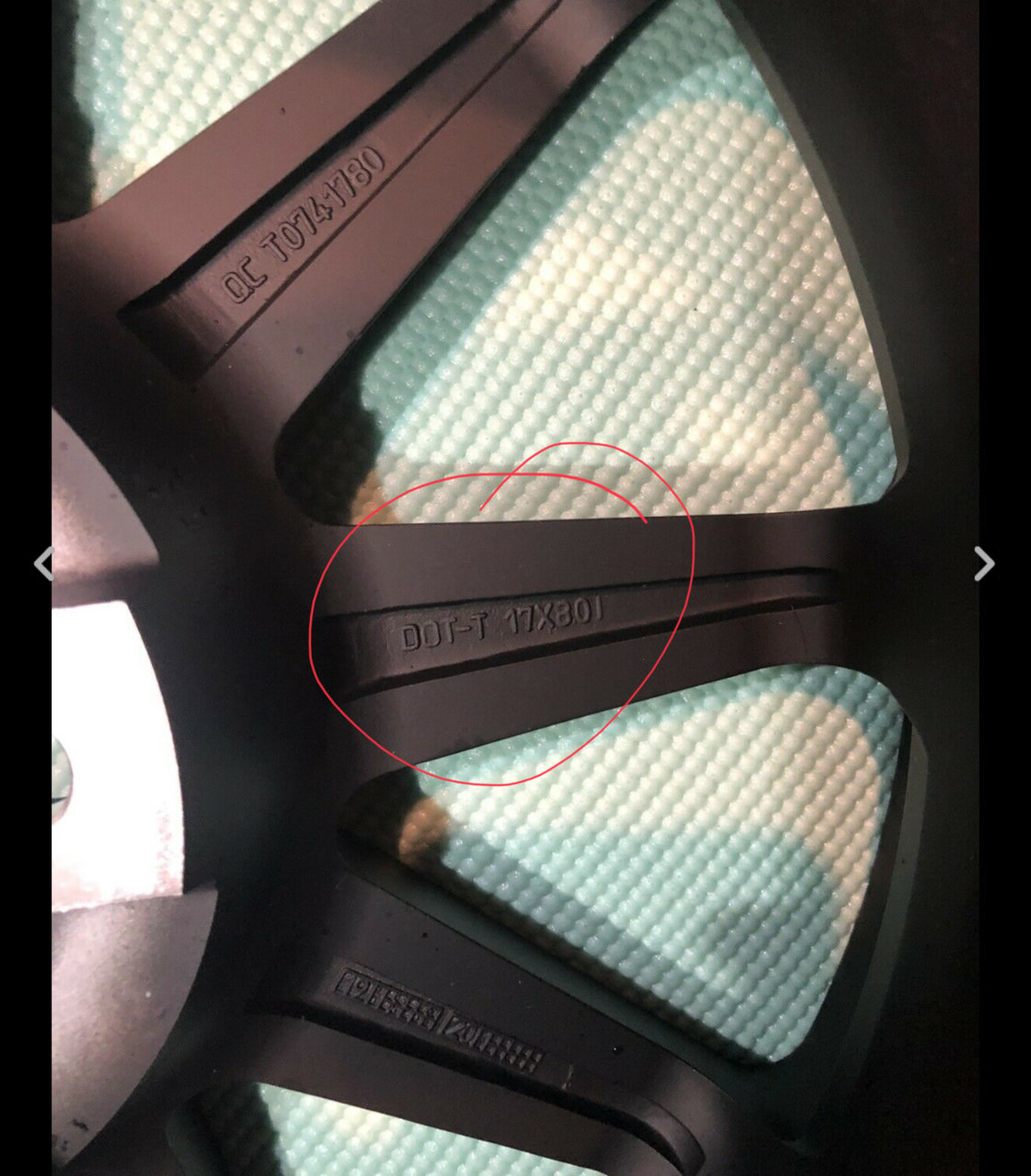

    Every wheel I’ve ever seen has the dimensions on the back, like this:
    (That’s a Method 501.)

    Clearing things up
    King Stage 3 3” RR Coil Overs SPC UCA’s
    BFG K02 (315/75/R16)
    Rim 16x8.0

    Found it...just needed to clear some mud :anonymous:

    Just know that adding a spacer will push your front wheels in the back of the fender which means you'll now be doing a cab mount chop or a cab mount relocate at a minimum. You won't be able to adjust it out with the control arms.
