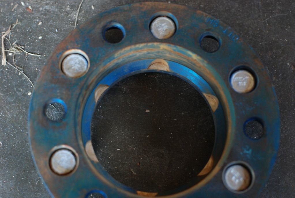

    Hub centric spacers may not clear the manual hubs and may require modification to fit...I am running lug centric spacers on my truck with manual hubs and after many miles of abuse on 35s they are still going strong.
    Here is some info on the modifications: DSC_0213_be04d935ea2adc76ff26330e314e852a9827499f.jpg

    @Wulf is right, Hub Centric wont fit manual hub without modification.
    I run Spidertrax hub centrics with my manual hubs, but I modified them like the picture he posted.

    It doesn't matter on brand. All hub centric spacers would need to be modified to fit with manual hubs.
