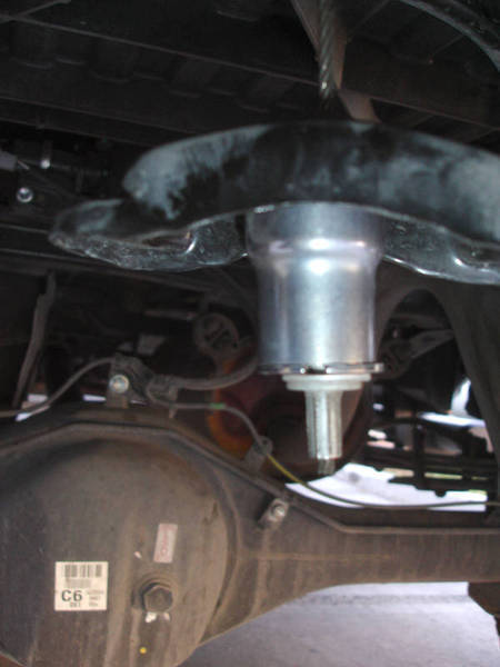

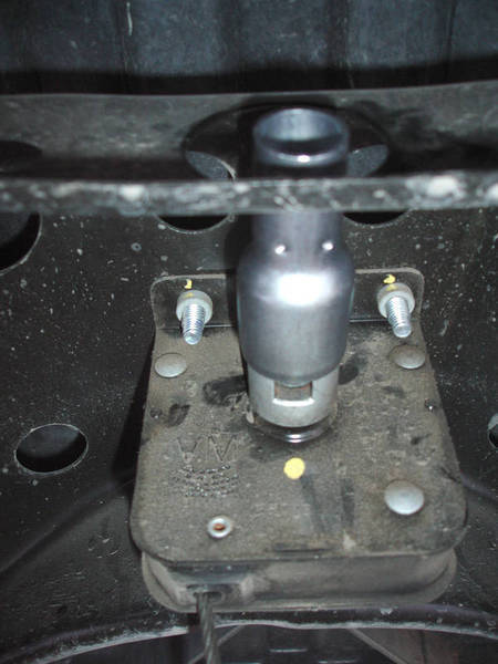

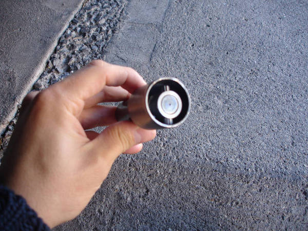

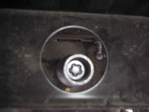

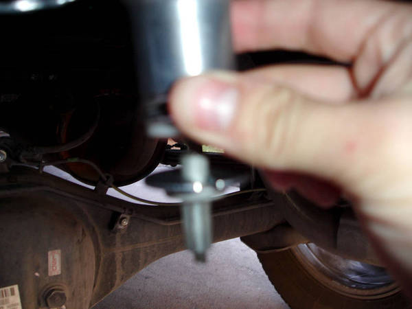

    Sometimes printed instructions are kind of confusing so:
    1. align the lock assembly with the lowering screw
    2. after this, you wanna hit the lock assembly with a rubber mallet to fix it in its position, this only works with pressure.....

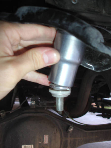

    3. Installing the shroud (the other hollow tube) this prevents the cable from being cut
    4. insert the shroud with the small end facing down below the black thing :)p) that holds the tire

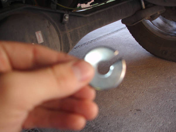

    5.now take the washer and pull the black thing, the spring and the shroud up so you can see the cable....
    insert the washer
    it should look like this
    there ya go! hope this helps!
