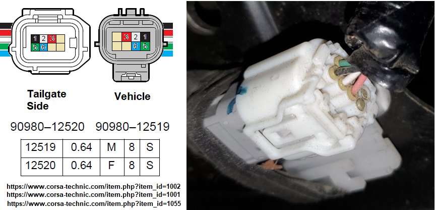

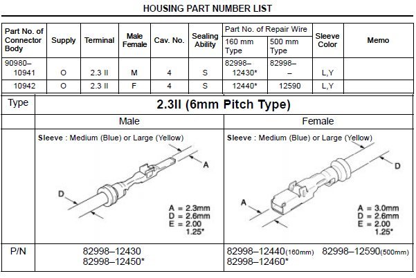

    Just got a new 2022 TRD Sport Premium and noticed the same thing. It did not come with the connector kit to plug off the backup camera when removing the tailgate. I check with my sales guy at the dealer and they could not come up with this kit. Nobody from the dealer knew anything about this connector kit. We actually checked the other 3 new Tacoma's on the lot and none of them come with this connector kit. Guess Toyota deleted this kit.
    I did find this diagram from another thread, which has the connector part numbers. Which are available here:
    https://www.toyotapartsdeal.com/oem/toyota~electrical~connector~90980-10941.html
    https://www.toyotapartsdeal.com/oem/toyota~housing-connector-f~90980-10942.html

    Have you verified your 2020 connectors? They are NOT the same type.
  13. Jan 24, 2022 at 9:02 PM
    #33
    chromemykiss
    chromemykiss New Member
    Aug 19, 2017
    #227292
    3

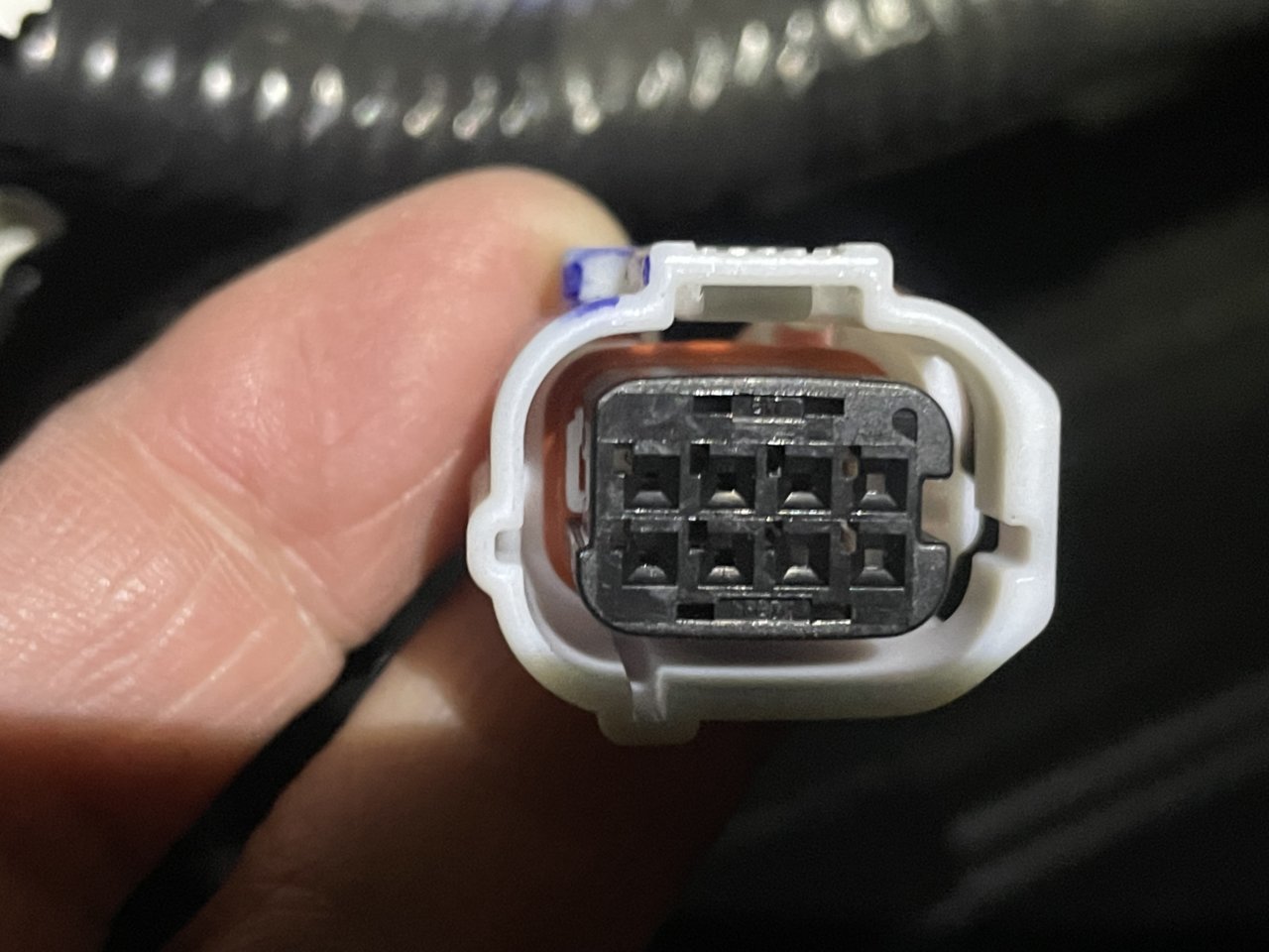

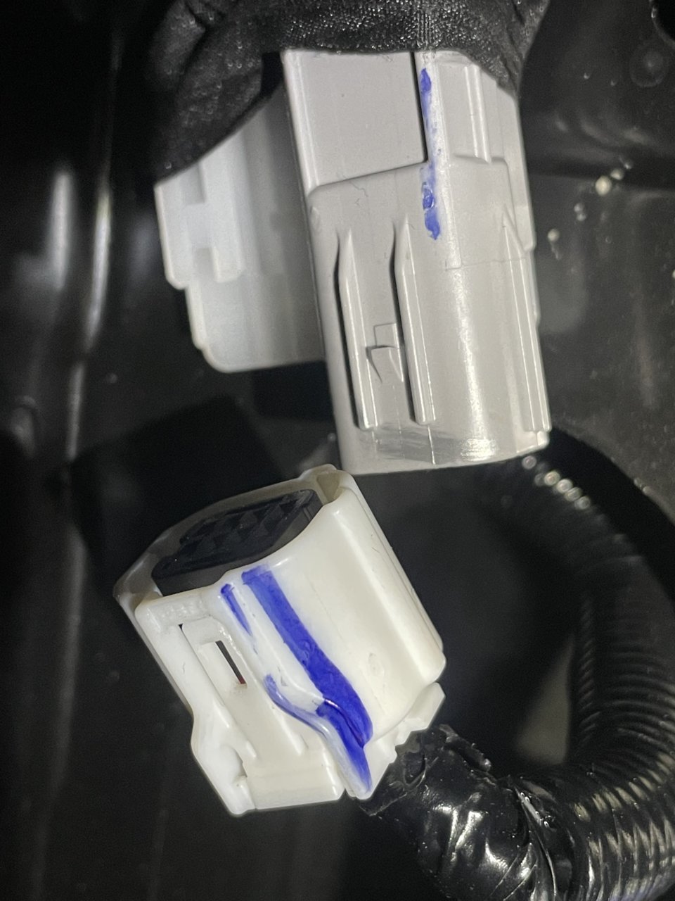

    You are correct. I crawled under my new 2022 TRD Sport tonight and verified that the connectors are different that the previous gen 2.5 connectors. I looked into the 8-way connector that Toyota uses on these Gen 3 Tacoma's. They are the following part numbers:
    - 90980-12519, Housing Connector M
    https://www.toyotapartsdeal.com/oem...year=2021&submodel=&extra1=&extra2=&filter=()
    - 90980-12520, Housing Connector F
    It would be nice to know what the connector kit part number is. Make it a lot easier to just order that.
