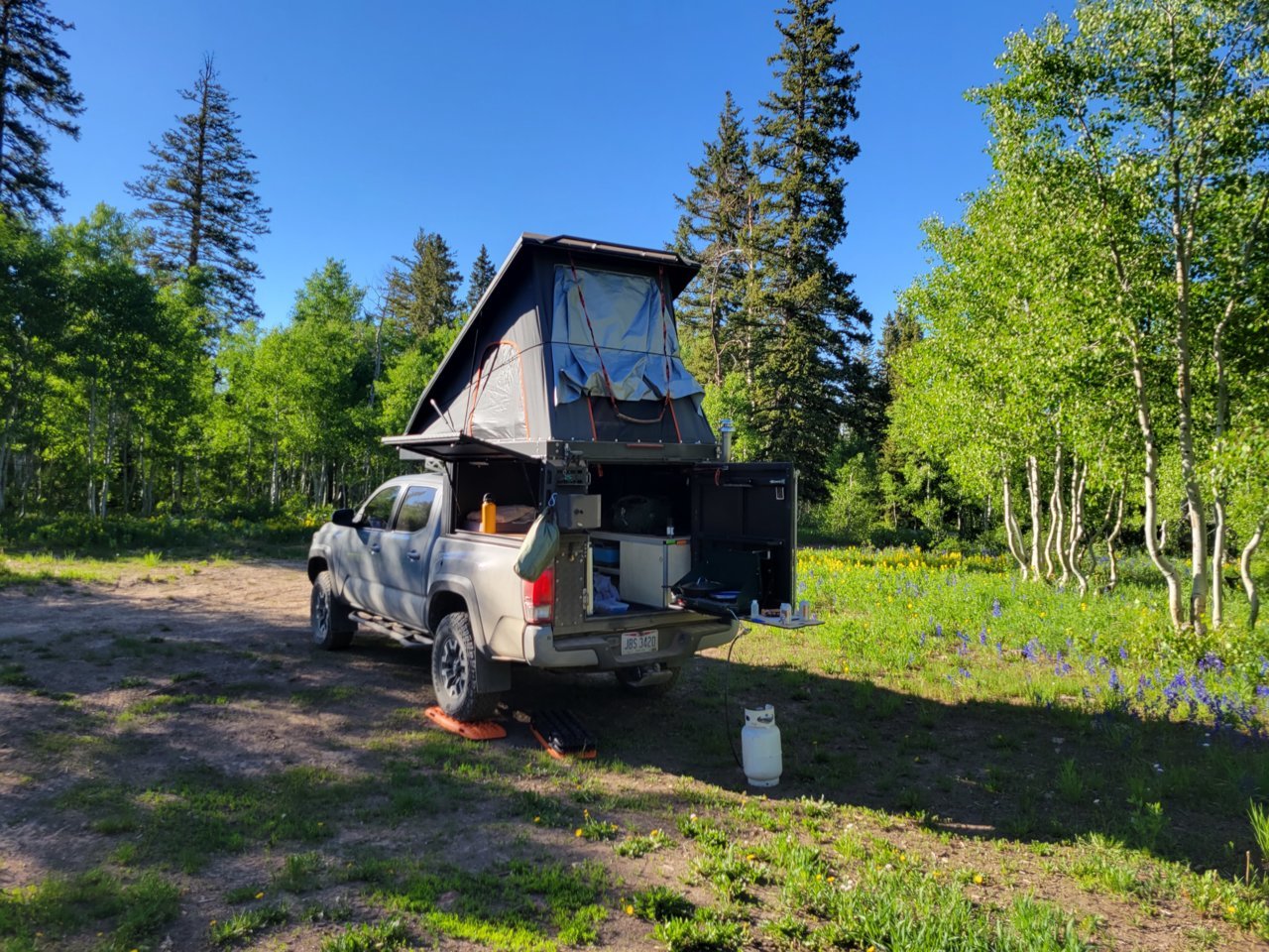

    I appreciate everyone replying to this thread,
    Probably should have put it in the original thread but the intended use would be an auxiliary tank, with a fuel pump that is manually actuated. With a filler neck running up and punching through the side of the bed.
    I'm going to dig into a few of the things that people have posted then it's probably time to start buying and fabricating

    I think I'll shoot Jesse an email and get cracking on this. When I do install this and get it working, I'll post up a full w
    I'd love to be able to use the titan tank side kick, but at least for me it wouldn't work, it has to be where the spare tire is. Can't put it inside my living space.
