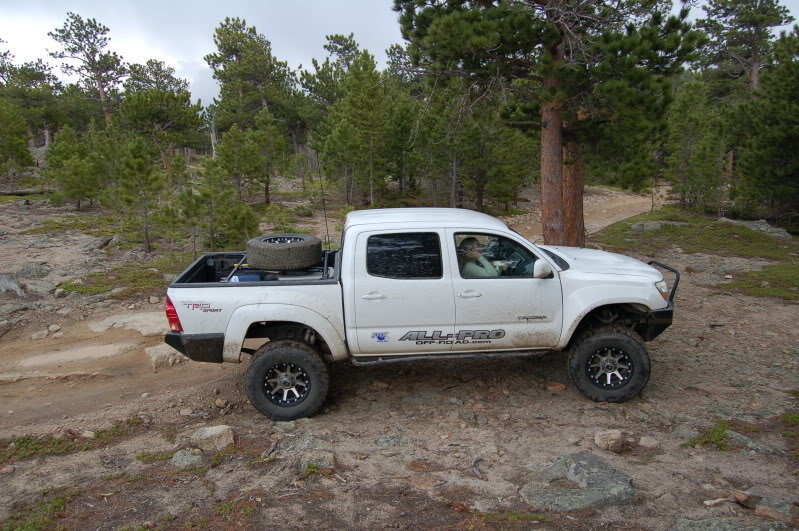

    ^^ X2 lol. cool pic though. I really like that tire carrier with the bent square tube. looks really slick.

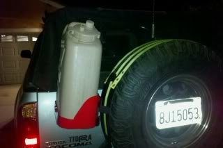

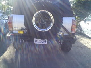

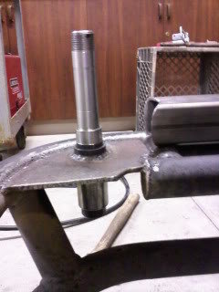

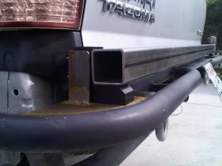

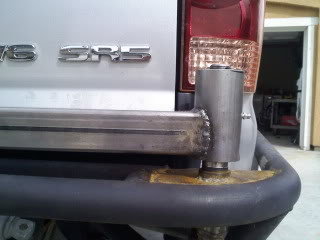

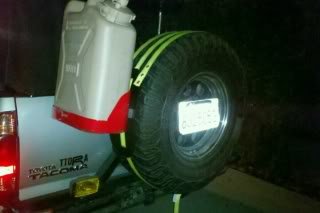

    here is mine. not bad for making it in my garage.:D
    With my removable water and gas carrier, also made in my garage:D

    I've seen this guy's truck in person, it's amazing, one of the cleanest 2nd Gen expedition trucks on the board.

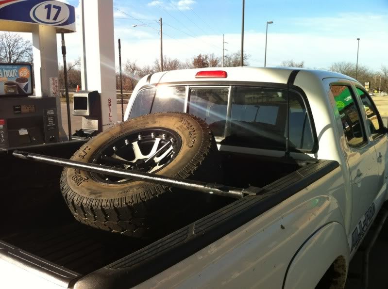

    I built mine on a twin bed bar system. The tire carrier has three bushings; two in the front, one in the rear. It can sit an angle or can sit horizontal at bed rail level. The bed bars slide in the tracks, so when I have the tire down I slide the second bed bar over the tire to pin it in place. The bed bars have tabs for antennas and back up lights.
