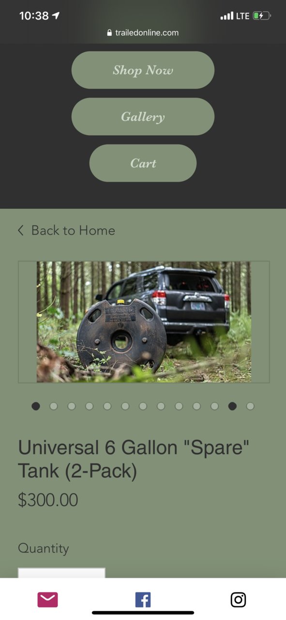

    these are what I was talking about. I guess they’re only certified for water storage but while searching I found some fuel ones

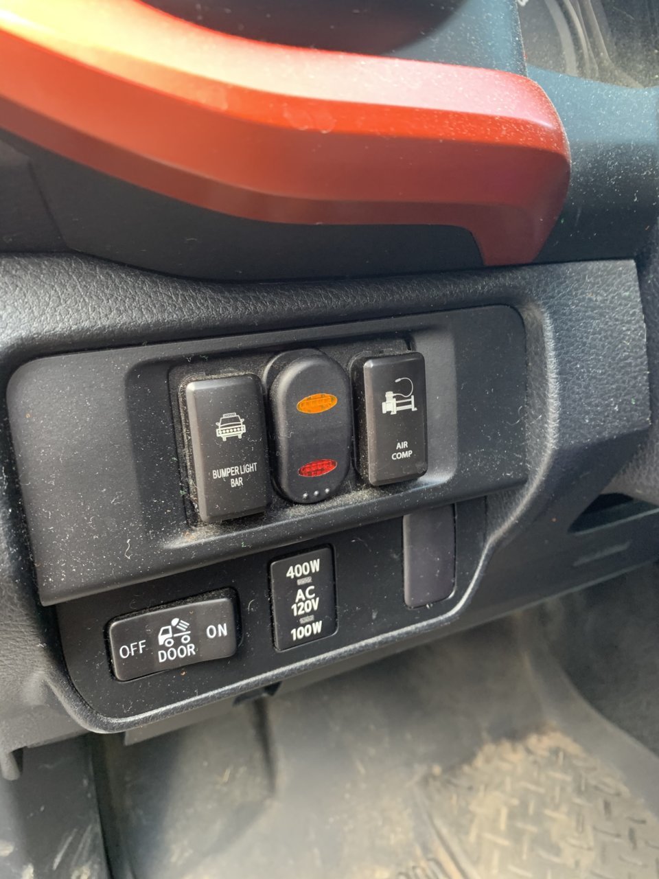

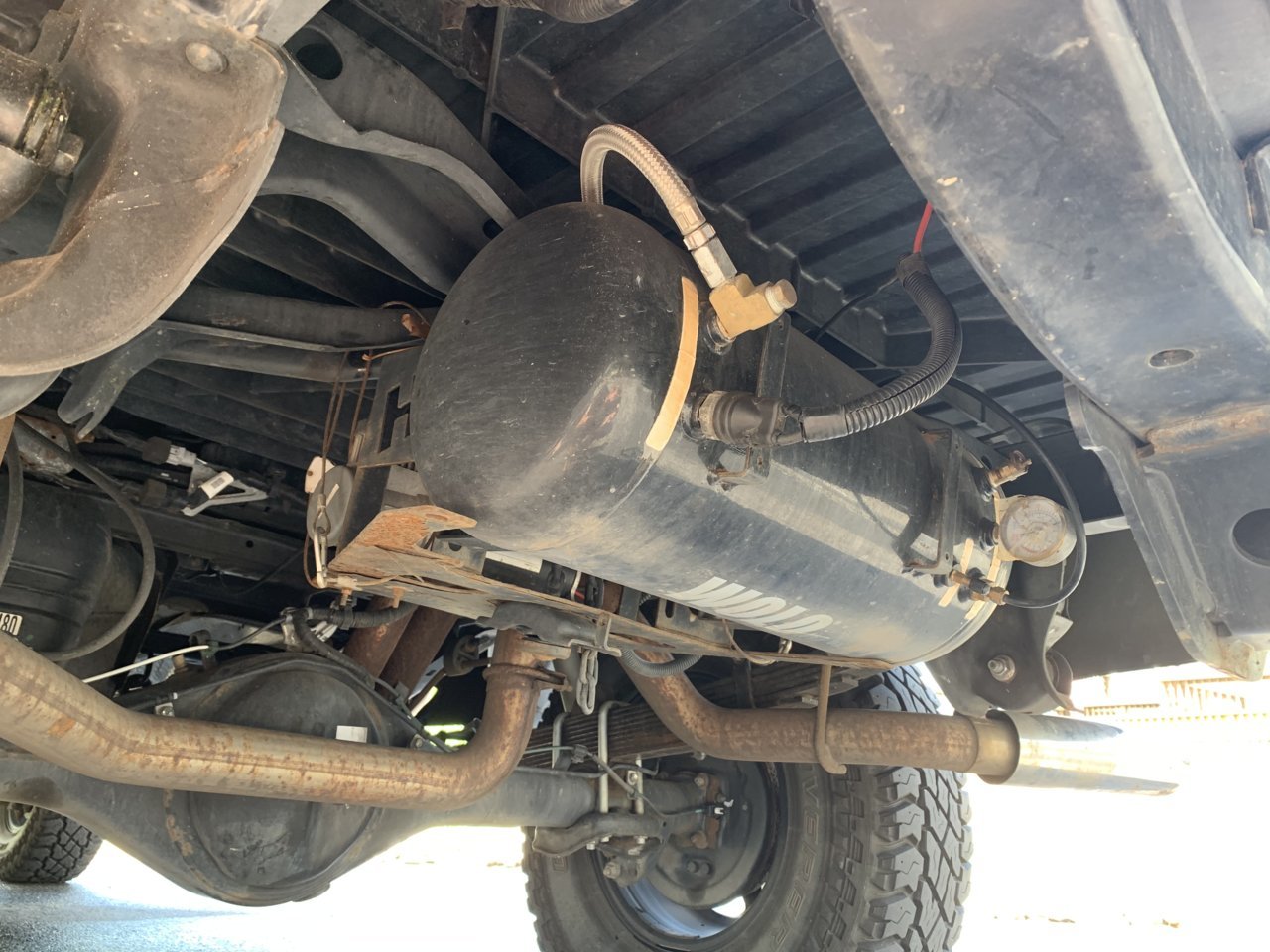

    D8CDAA75-B677-48D3-8EC1-A7619AE0034A.jpg 6DAC165A-D38F-4196-8A55-AE3A515DF8CD.jpg
    it’s been under there for a few years at this point. Got a little rusty

    Nope, no build page. Kinda glad I don’t because then I’ll have to think about how much I’ve spent on this truck :rofl:
    I got a tank and compressor kit from Wolo, just a cheap-ish kit that can keep up pretty well. I got the “spare tire delete bracket” from hornblasters and I had to modify it a little to fit the 5 gallon tank. I ran all the wiring through some wire loom along the frame near the factory wiring to a 30 amp relay and a 25 amp fuse in the engine bay. The compressor draws 22 amps on start up. I also have a solenoid and 1/4” air lines hidden/protected throughout the underbelly to feed my air horns :D
