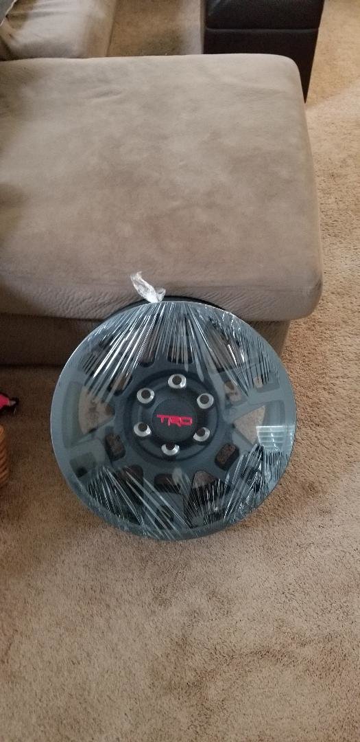

    My spare tire arrived last night. Big question now should i get a fifth TPM sensor for the spare tirespare.jpg so i can rotate it on and off?

    Yeah! I would. 5 tire rotations will give you the most bang for your buck. Imagine a set lasts you 4 years on average. Now it will last 5

    No, unless you will be getting it coded each time you rotate it in.
    The computer can only store anda display four sensors.

    If you have a reputable tire shop, or really any tire shop near you with a tpms tool they should be able to swap the sensor over during rotate no problem.
    In our shop we break the bead near the sensor, hold the bead down while removing the sensor and replace the sensor with a rubber valve. Do the same thing on the spare that is to be mounted on the truck but replace with the tpms. Don't need to re-balance the wheel/tire as the tire position on the wheel doesn't change (but we do anyways). Lastly, do a tpms system relearn.
    Might add 10-15 minutes to your wait at the shop but you wouldn't need to purchase a new sensor and worry about having to mess with programing. Just be sure to give the shop a heads up when scheduling.
