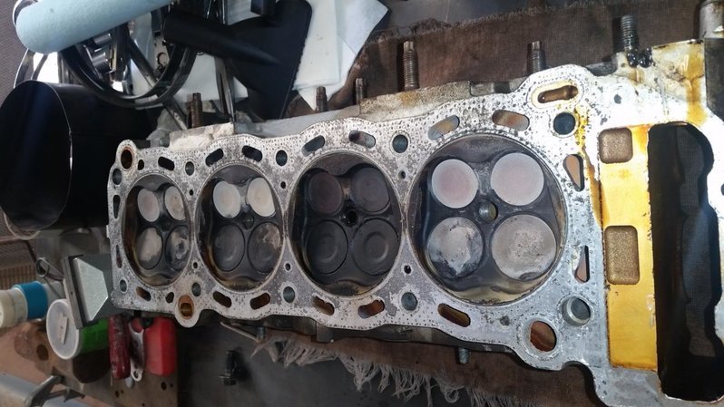

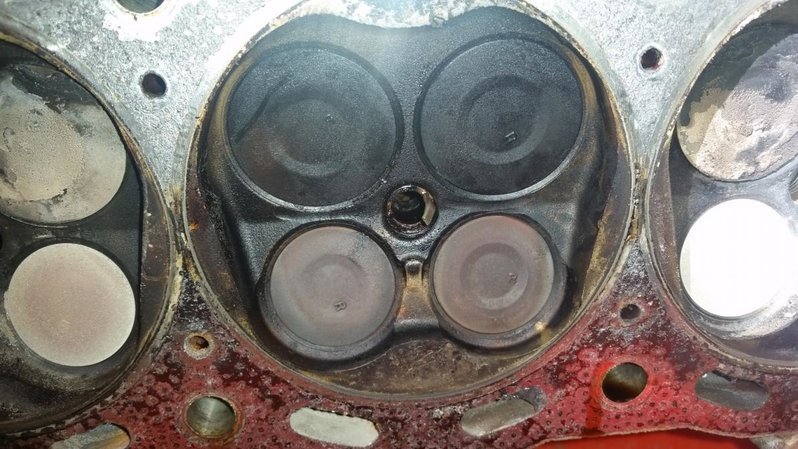

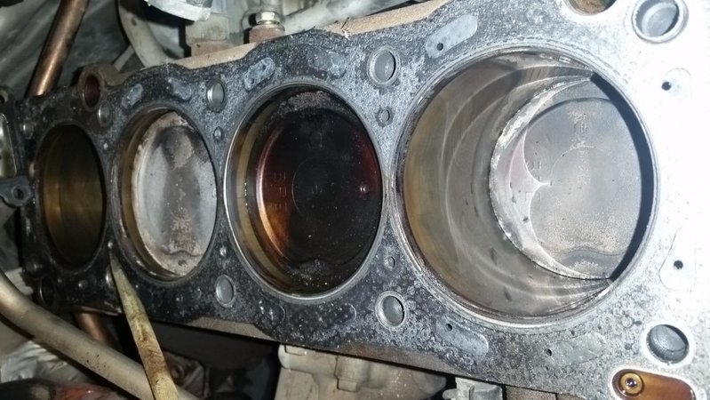

    UPDATE;
    The head is out and the broken extractor is out, what a pain in my a**. Here are some pics.block1.jpg block2.jpg head1.jpg head2.jpg

    CD20H
    CD20H Well-Known Member
    Oct 25, 2014
    #141019
    763
    Ben
    North Texas
    2004 Double Cab TRD 4x4 Limited
    Magnuson Kompressor, OME lift kit, JBA Headers, junky Sony radio.
    Now comes the fun part. Cleaning up those threads.
  16. Feb 9, 2016 at 3:22 PM
    #56
    930dreamer
    930dreamer [OP] Well-Known Member
    Jan 17, 2016
    #175259
    49
    04 Tacoma Prerunner
    Broken plug still needs to come out.:(
  17. Feb 9, 2016 at 3:25 PM
    #57
    CD20H
    Oct 25, 2014
    #141019
    763
    Ben
    North Texas
    Oh. If you are in doubt. Take it to a machine shop and have them do it.

  20. Feb 9, 2016 at 3:32 PM
    #60
    930dreamer
    Jan 17, 2016
    #175259
    49
    04 Tacoma Prerunner
    I'm not so sure I shouldn't just put a rebuilt engine in while I'm at this juncture?
