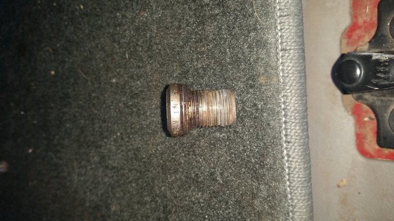

    My wife picked up the head from the machine shop, they had to drill it out the #2 spark plug. I'll post the pics when I get back into town tonight.

    Here are the head pics. 20160220_074622.jpg20160220_074606.jpg20160220_074555.jpg20160220_074536.jpg

    Nice! I'm happy to see that thread came out :thumbsup:

    If you look at the electrode, it had been compromised for a bit, that would contribute to the carbon build up. Anti-sieze is your friend.
