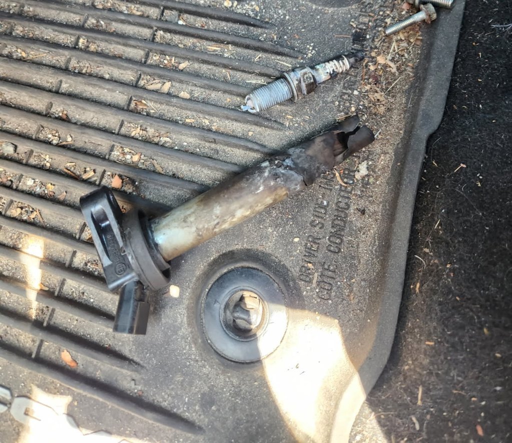

Spark plug ejected on my 3.5L, stripped head

    So, my 2017 TRD Sport purchased certified preowned at 7k mi has required nothing but oil changes and brakes up until now, always dealer serviced. At 118k my engine apparently spit out a plug and stripped the threads on the head. Heard a progressively worse ticking noise for a second, rough idle, by the time i pulled over and then tried to move the truck to a better spot it lost power and that was it. Towed to dealer who diagnosed the issue.
    Head is roughly 8500 all included, used engine coming to around 9500 depending on what they find. Reached out to Toyota corporate for possible assistance, call back a day later saying case closed you're on your own.
    I declined plug service until next visit recently and they might be using that against me here. Can't imagine this is normal for being slightly over for plugs, though?
    So really I'm just putting this out there for the record and also wondering if anyone had any info or advice that might be helpful. Ive searched and seen a lot of reports of loose plugs from the factory but very few stripped heads as a result. I was also sent a screenshot of a Toyota tech facebook group reporting plugs coming loose on a lot of Tacomas around 130k recently.
    Has anyone had any luck with a product like Time-sert inserts on the 3.5L? Can it be done without pulling the head? Toyota tech said he was skeptical it would hold due to "that area getting very hot and cold frequently."
    Any thoughts from you all are appreciated. Not a great time for such a huge expense on my end and not sure about spending so much on a vehicle with 118k already despite many going to 300k+.

    I do ALOT of sparkplug thread repairs using "time-sert" brand inserts, specifically designed for sparkplug thread repair.
    Cylinder head does not need to be removed to do this type of repair & will last the life of the engine if done right.
    I DONT recommend the cheaper kits that you can get at the local auto part store....
    Do you have any engine rebuilders / machine shops in your area, make some calls, they may do it for you & have the kit....
    The time set tool kit isnt the cheapest but far superior than the rest of the inexpensive kits...
    You only have 1 shot, do it right.....

    Time sert it...be good as new

    If toyota doesnt assist, ide do / try an insert from a reputable shop before I tossed a head at it....
    I charged 4.0 hours labor on any ford, + a new sparkplug & coil.....
    You also want to check your remaining plugs checked for tightness, or replace....

    There are specific maintenance requirements for spark plug replacement, oils, etc. You have done none of that?!?
    That plug has been loose for many thousands of miles for sure. If all the OEM plugs had been replaced at 60k miles, the new plugs should have been torqued to 13’/lb spec.

    Thats cuz everyone you called so far sucks & are clueless....
    Ive been a ford engine tech for 32 years & the 5.4L, 6.8L / v10 with aluminum heads have been ejecting spark plugs forever....
    Ive literally have inserted probably 500 sparkplug holes & probably twice as many engine oil pan drain plug holes....
    Even ford has their own branded kit now, along with ford ESP warranty authorizes inserts vs replacing the head....
    Not a bad idea at all & will save you $8k if you find someone who has a clue....
    Start digging deeper into engine rebuilders, machine shops....
    They all use them, its common practice in the machining world....

    I've seen quite a few 3rd gen v6 3.5 Tacomas with loose spark plugs from the factory. Enough that I would recommend doing them early. Or at least checking torque on them before the scheduled maintenance.

    thats what happens...
    They get loose & every time they get hammered from the sparkplug firing & compression, they rotate counter clockwise & damage the threads badly....
    Very doubtful that just cleaning up the threads with a tap will work....
    Has only worked on one ford for me, usually the threads / metal is gone...
    Look at the coil boot, burnt to fuck, that didnt happen overnight.
    Its been making a very slight tick noise for a long time but the coil muffles the noise...

    Might get lucky & it may accept a new sparkplug without any tapping or anything, ive had that happen once also.....
    We dont have a picture of the threads in the head.....
    Thing is since its not a common accorance with toyota, they may be clueless about the time-sert option.
    Or, go down there & talk to the shop foreman, maybe he's familar & theres a tech at toyota that does them all the time.....
    Just not the tech that was assigned to your vehicle.
    I was terrified first time I installed one in a head....
