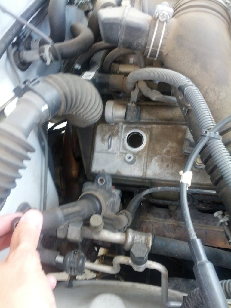

    2. check out and remove the hoses and such that are blocking the cylinders (don't have a pic of it clear, but you get the idea)IMG_20120615_114741-1_86e06f907e760ead1f9ffbf97fa849422b41c0a8.jpg

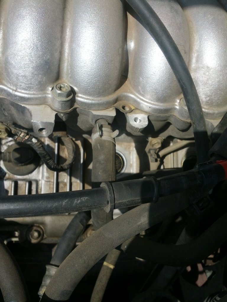

    3. remove the bolts and wires from the coil packs, then pull out the boot gently and set it to the side, on a clean surface. wipe off the cylinders carefully, making sure not to get any debris into the cylinder itself.IMG_20120615_132922-1_de99f1d2462cc67a9df097ac71c7b48b68b468a0.jpg

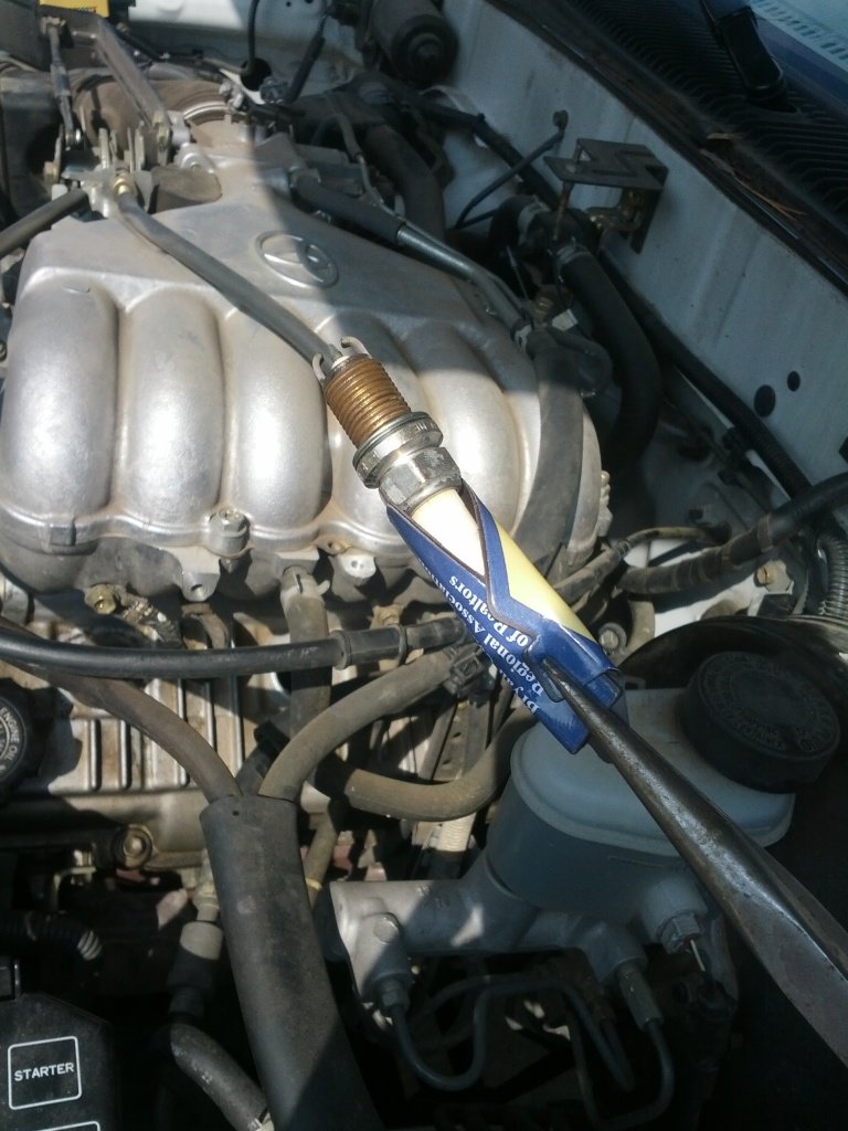

    4. ratchet out the plug until its completely unthreaded. and here's the tricky part. You could try your hardest to get the plug with just needle nose pliers, or you could make a ghetto parts grabber like me--
    that is a ordinary kitchen magnet wrapped up and held with my pliers, worked on the first try. just slide it in and around the plug and pull out (gently).
    5. all you have to do with the new plugs is apply the lube that comes with the plugs (autozone) and then drop them in and ratchet til they're tight, but don't over tighten and strip them.

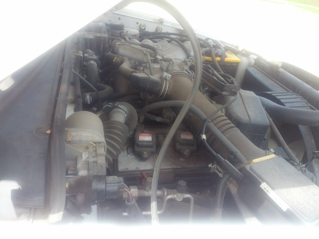

    6. the driver side boots will simply pop out with enough force (once again, pull gently)IMG_20120617_164808_34cd7b99a4843ab9f72bc157e45fb7853d34cd9b.jpg
    once again you'll want to remove a couple items that are in the way, should be 10 mm bolts if your engine is like mine.
    7. lay those boots to the side, repeat the same steps with the plugs, slide in the new plugs, ratchet, replace the boots all around, and then replace all the hoses and things you had to move out of the way and you're done!:D

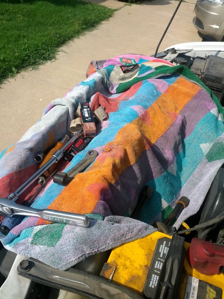

    (tools and stuffs)

    you know that they make spark plug sockets with little rubber boots that do this for you???

    Don't get me wrong, I'm all for ingenuity, but isn't that what a spark plug socket is for?

    the spark plug socket i have doesn't. and instead of buying one i got smart

    Man you need to clean that engine bay. you should spray it down with a Degreaser like simple green or purple power, Let it sit for a minute and then hose it down. It will be som much more enjoyable to work on when it is clean in there. Also if you really want it to POP Throw some tire shine on the black parts and your engine bay will look better then the day it was new. Good Write up though and I like the idea with the magnet for those that might be a spark plug socket short of a full socket set LOL.
