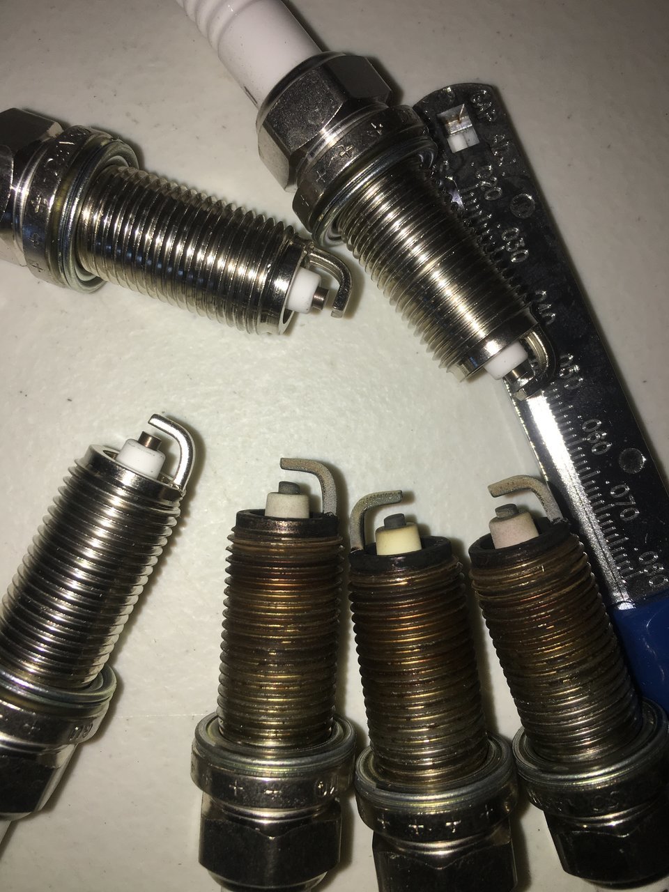

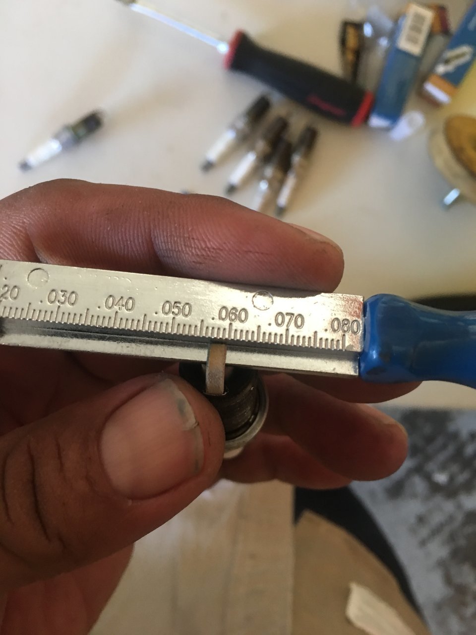

    i just changed my plugs. got it done in under an hour. more like 45 mins. i measured my old plugs. almost .06.
    i adjusted my new plugs to about .038, just a hair under .04. started up great. have to wait and see what happens in the cold morning. i am happy camper.
    not a lot of wear on my plugs but gap was huge...

    now that i think about it maybe that .038 is a bit tight. oh well i’m gonna see if a cel comes on if not no worries. i don’t have smog any time soon i hope.
    i think book is .044 :annoyed:

    so 30-40 miles later, no check engine light... and this morning starting my truck up, it didn't skip a beat like it did yesterday. prior to changing my plugs, in the morning on a cold start i used to have a hesitation, almost like missing a beat, after maybe 1 or 2 cylinders into the crank cycle, the truck would fire up... now that is gone. still think my gap might be a little too close, but no CEL's and its running good so im going to let it ride until i have any issues.
