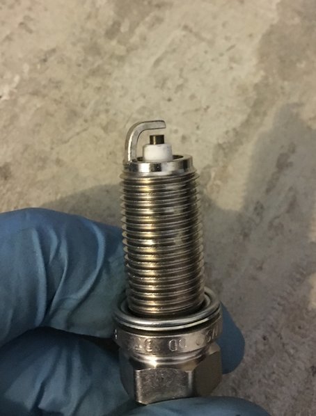

    Just changed spark plugs @ 45k miles. If look at pics will see the wear (erosion) on them.
    Definitely that is why manual says replace every 30k for the V6.
    2013 taco DB TRD OR, v6 4.0L
    Stock DENSO K20HR-U11

    I just changed mine at 38,000 miles and they didn't really look too bad. I would expect they could have gone a little while longer but it wasn't too bad of a job.

    4.0L doesn't use the iridium, but I think you can find iridiums that fit.

    The sixes of mine looked like in the picture.
    I use 87 octanes regular, if that matters.

    It can if you put them in. V6 takes same Iridium plugs as a Lexus ES350. My Taco is going on 95K with NGK LFR6AIX-11 Iridiums. I did pull them out at 85K to clean and re-gap. One thing I have learned; don't get entry level Iridiums. Get the ones with nickel ground electrodes; they will last longer without re-gapping. My next set, Denso Iridium SK20HR11, are sitting on my work bench...

    What were the gaps on the removed plugs? Were the NGK plug gaps on bank 2 slightly larger?

    gap set at for Denso k20hr-u11 0.34-0.41

    1.1mm
    That is the 11 at the end of part #

    I would've just put new ones in at 85,000 instead of cleaning and re-gapping etc.

    Engine was running fine; my intent was to check them and clean them, which I should have done at 60K. Iridiums usually last 100K (120K recommended for the Lexus).
