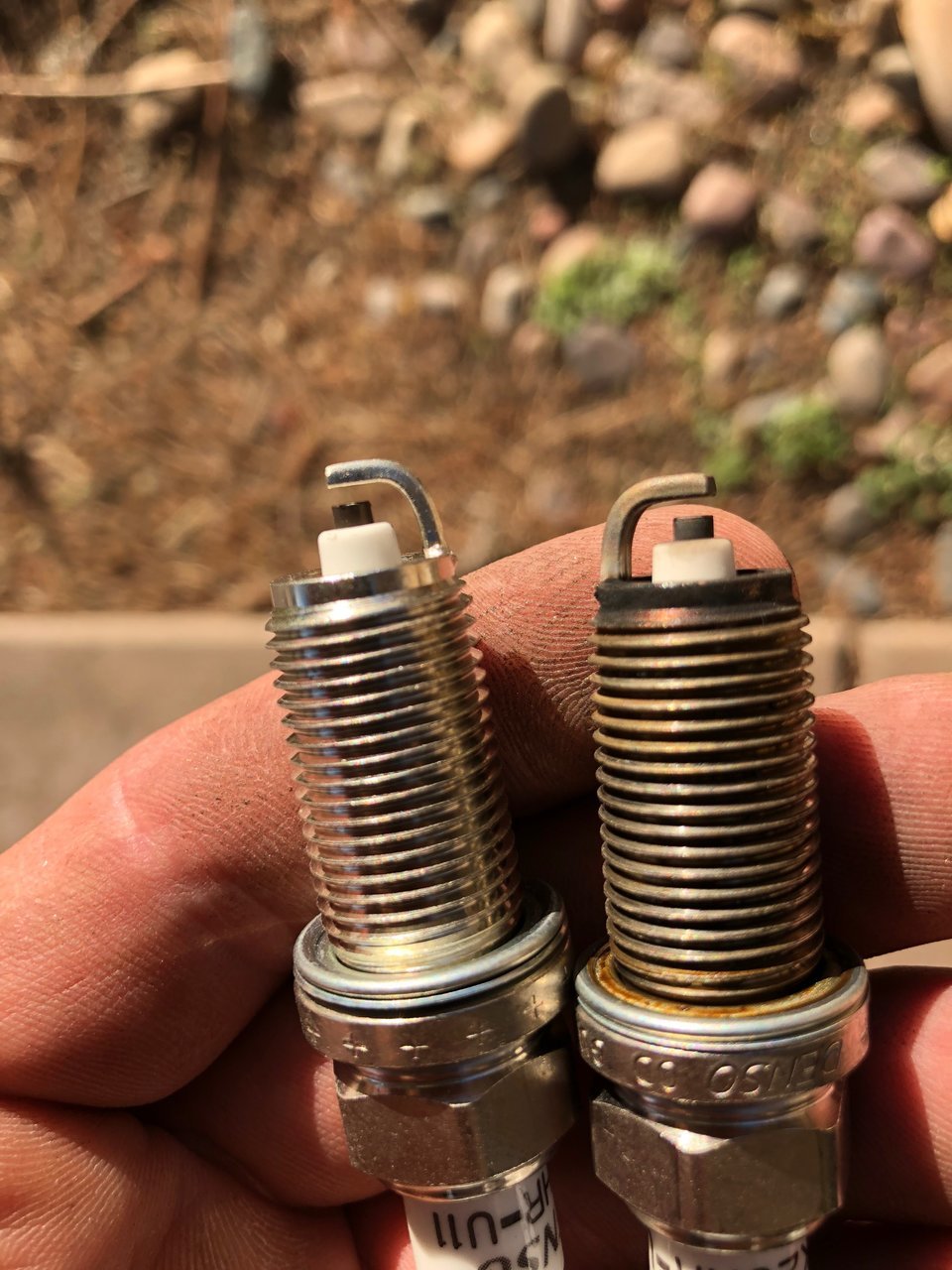

    IMG_5221.jpg So i got everything to replace the spark plugs. Pulled a couple out and they don't look very worn (plug on left is new, plug on right is pulled out of motor). I've owned the truck for about 3800 miles now, so im thinking the dealership i bought it from probably already replaced them. Should i go ahead and wait another 30k miles? No sense in wasting money if i don't need to.

    You could clean the MAF and the throttle body. Pretty simple job. Not more than an hour. Easier than the spark plugs IMO, the front 3 on the right (if you're looking at the engine, from the front of the truck) are really annoying. Might help with your MPG's, might not. Depends on if anything is super dirty.

    Toyota is part owner of NGK and Denso, which is why, I think, they have Denso plugs on one side and NGK's on the other. Although that wasn't the case on our same year Lexus 3.5 V6. Thus, whatever plug NGK and Denso show in their catalogs for our Tacos will be fine. I just put 101K on my NGK Iridiums; truck truck ran fine till the end but the ground electrodes were starting to wear down. Repaced with Denso Iridiums Long Life and expect same mileage from them. The 30K replacement recommendation is for emissions purposes; says so in the manual; so, you can go 40-60K on copper plugs - just check the gap and check for fouling.

    No, you don't need to change those. Save your new ones for the next change in 30,000 miles. I think I did my last change at 50 ish and the ones I took out didn't look too bad.
    No need to change those.

    This is just my opinion but the 30k interval is overkill, at least for the type of driving my truck sees. I changed mine in my truck the first time at 30-ish and the ones I took out looked fine. The next time, I think I went to 50 and even those could have run a bit longer. The only time I've noticed a difference changing plugs (and I know this is extrememly subjective) was this last time. I bought a set of E3s and I'm certain I can feel a difference. I've only filled up four times since I last changed them and I am getting about a mile per gallon better. I usually get 17-18 mpg. For the last four tanks, I've been getting 18-19 mpg.
