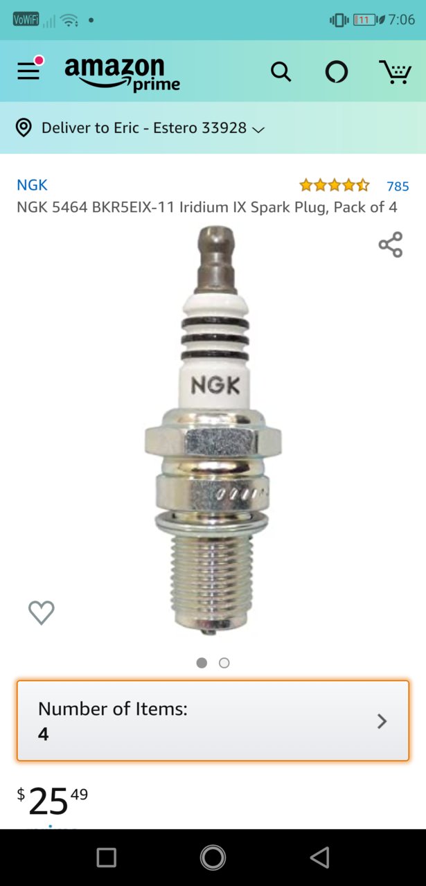

    Hello everyone I was wondering which spark plugs are the best for a v6 2004

    Well these work

    Is it true its recommended to use the double ground spark plugs for our trucks? Mine currently has NGK single ground. Does it make that much a difference ?

    Do what the replies above are telling you. At $3 a plug, $18 total, that's cheaper than what you're looking at on Amazon and its what's recommended by the manufacturer.

    Do you have the 3.4? Dual electrodes for that engine.
    There have been 10,000 posts arguing about it to death (some say you can use single electrode no problem).
    But I’m going to side with Toyota on this one and go with the OEM spec/recommendation of dual electrodes.

    With waste spark systems like the 3.4 the dual ground is ideal. Waste spark fires @ TDC everytime so twice as often, thus a dual ground is prefered.

    @Bishop84 @Madjik_Man Thanks! I have ordered OEM plugs and wires. Time to get this autozone crap off my truck. Hopefully my mileage is a little better as well.
