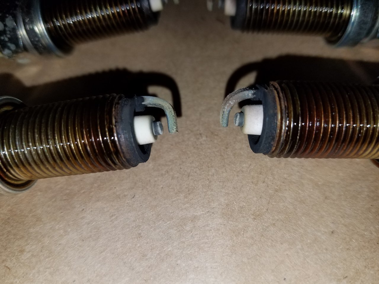

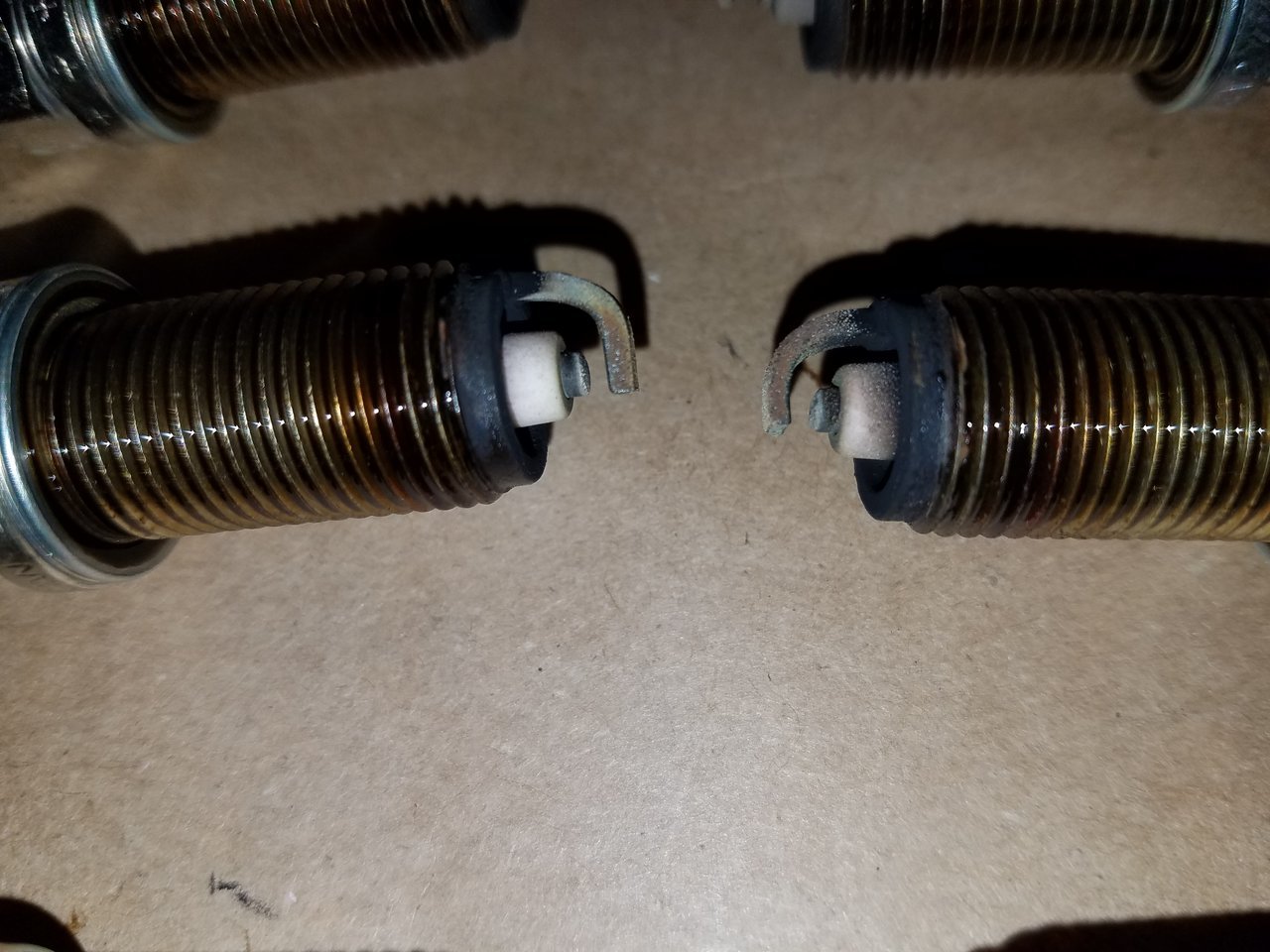

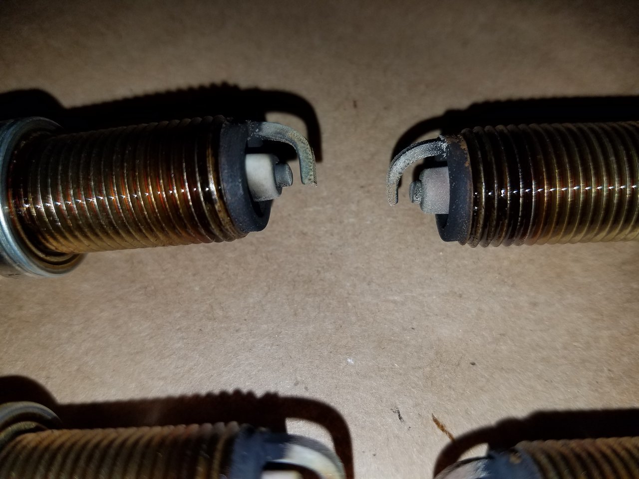

    I replaced my factory plugs (I assumed they are factory because of the split brands and my truck was at 38k)
    Here are the differences I saw, Denso on the left and NGK on the right
    Cylinder 1 on the left cylinder 2 on the right Cylinder 3 on the left cylinder 4 on the right
    Cylinder 5 on the left cylinder 6 on the right

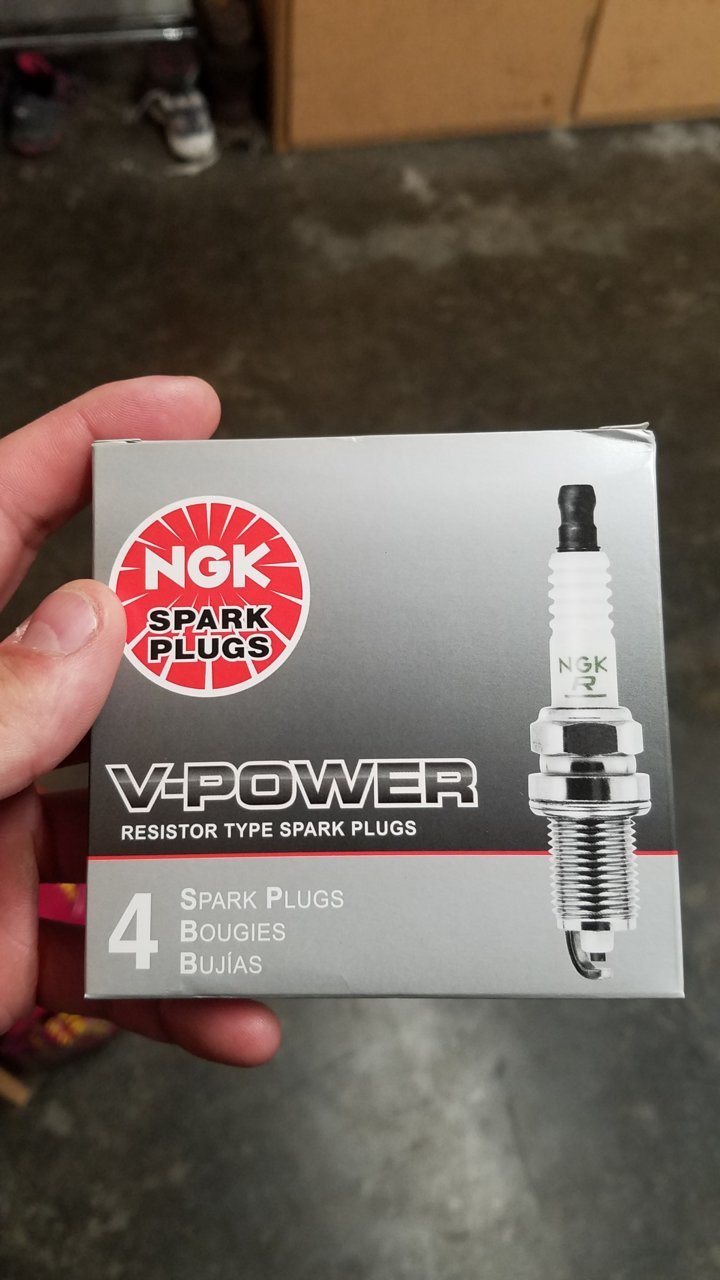

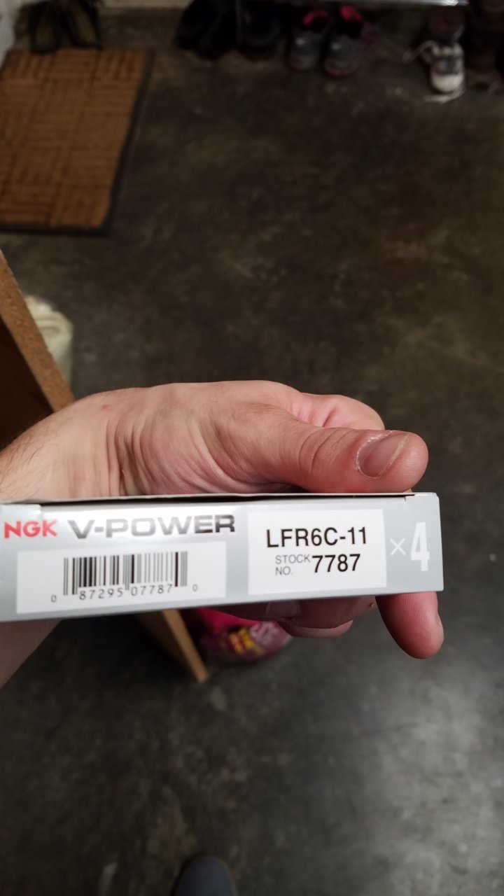

    Would these work? They are the copper ones I believe

    Been running these for over 20k miles. Runs flawlessly. Got 'em at AutoZone.

    Yes. Those are, in fact, called for if you have a 1GR-FE engine.

    Changed mine today - similar to RoastyToastyMan’s photos - the NGK’s averaged a slightly larger gap @ .051, Densos were .045.
