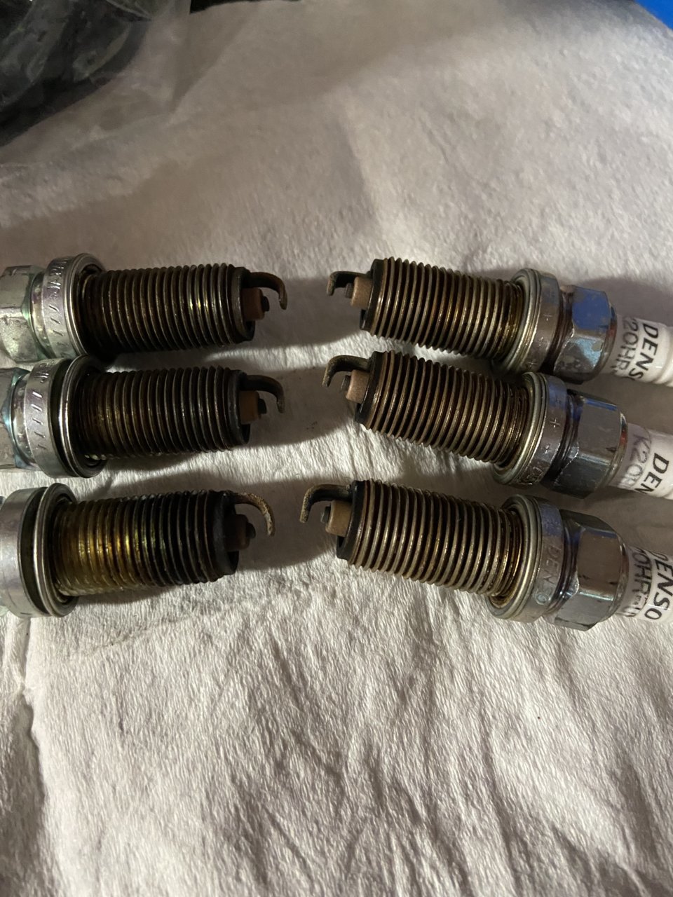

    Just did the 2012 I purchased a few months ago.
    Ngk drivers side denso passenger side.
    Replaced with the cheap denso ones.
    144k on it and the plugs had a .07 gap.
    The denso held up better I think!
    wi_taco and SR-71A like this.
